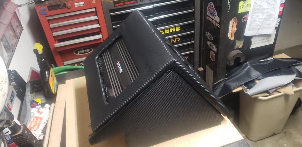

BillyR Posted April 12, 2020 Report Posted April 12, 2020 HI guys, I am new here so try not to beat me up too much. :-) Here is what I have going on. I have a system I just installed in my 2005 Corvette. The heart of it being the Eclipse XA5000. I have had it in storage for many years waiting for the time to install. Now its in but.... Have problems When I it power up, the 4 channels (front left and right, Rear left and right) work fine. The Sub however, will not come on....at first. After running music for about 30 minutes or so, the sub will all of a sudden come on and work fine until I shut down the unit. If I start the stereo back up instantly, it takes about 30 seconds or so for the sub to come on. I can hear the amp make a audible click when the sub starts. Things I have tried: I have checked all my outputs from the stereo to the amp. They are all good. I have checked for signal on all RCAs at the amp, again, all good. I have fed the sub power from another channel and it works. No blown fuses and all adjustment nobs don't change anything. Tomorrow I will be double checking grounds, but I thought that was a long shot as the other 4 channels work just fine. Its driving me a little crazy, ok crazy-er because this whole system was built around this amp, and not much will fit in the hole, and due to the worlds craziness , buying a new amp is not in the cards right now. Any help would be wonderful. Thank you and happy Easter and quarantine and all that good stuff.
