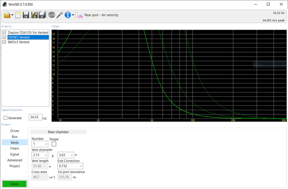

I've been playing with WinISD to try and design a sub box for the JL 10TW3-D4.  After modeling it, the port velocity was 30+ m/s.  The research I've done says it should be 17-20 m/s to prevent chuffing.  I tried other driver's recommended ported box designs and it was pretty much the same.  What's the deal?
FYI, the drivers modeled were JL 8W3v3 (50+ m/s),  JL 10TW3 (30+ m/s) and a Dayton Audio DSA135-8 (40+ m/s) at their full RMS power ratings.

have you looked at Trit's calculator on this forum for port size recommendations? It would be helpful I would bet. And Torres Calc/spreadsheet. I would guess a bigger port is going to lower your velocity but up your tuning freq. which would mean you would most likely have to elongate the port to drop the freq. Thats a super tiny port. Also adding ports will up freq. from what I have modeled.
But I am armchair quarterbacking this with a beer in hand. i.e. don't take my word for it ask someone with better knowledge, Trit/Joe X/Anyone but me.
So for example for a JL10W3(v2 in this case) Bassbox pro recommends a 1.5 cu ft box with a Fb of 34hz and a F3 of 26hz. This is with one 4"x 10.43" round, non-flared or precision port.
