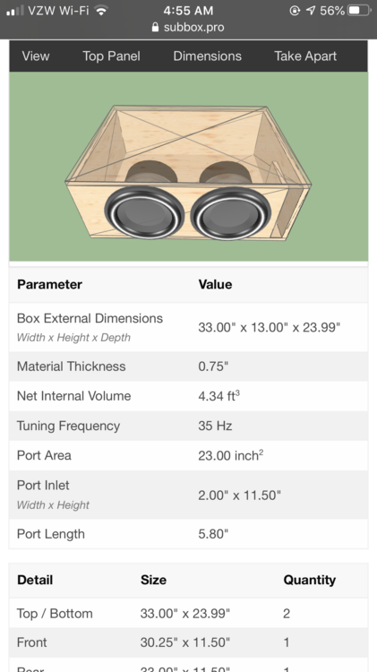

So I’m trying to come up with a dual 12 ported box tuned to around 35 Hz.
I have max dimensions of 33” in width and 13” in height. I found a program online that shows my port length needs to be 5.8” long. This seems too short for what I’m trying to achieve. Can anyone help?
Here’s a pic of the design from the website
