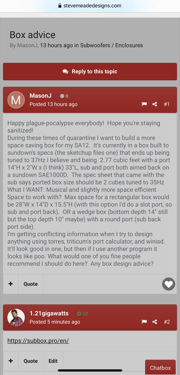

And I forgot to tell you that torres isn’t that accurate. Check out this post somebody posted earlier to corroborate. Plus I’ve always heard winISD isn’t accurate either.
