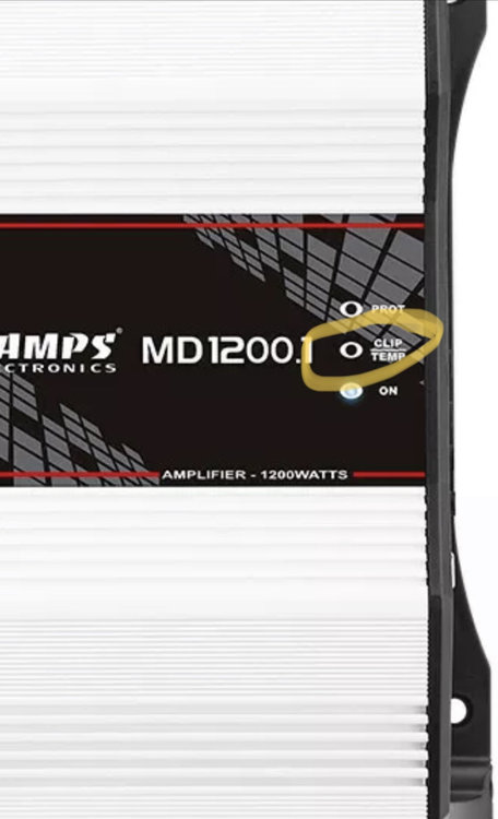

1point21gigawatts Posted April 18, 2020 Report Posted April 18, 2020 This amp would be ideal for that dual 4ohm subwoofer. It is a 2ohm amp and has a distortion detector so it’s easy to tune. https://www.google.com/amp/s/skyhighcaraudio.com/amp/taramps-md1200-1-2-ohm/ “How can we help you?” “And don’t forget to tell them that the customer isn’t always right.”
1point21gigawatts Posted April 18, 2020 Report Posted April 18, 2020 the distortion detector is where it says “clip”. When that distortion detector goes off and stays on constant or it starts flickering rapidly or too much intermittently then turn the level knob on the amp back some until it goes off or just flickers very intermittently sometimes, the less the better. Keeping that distortion detector off is the best. It’s one of the easiest amps to tune. “How can we help you?” “And don’t forget to tell them that the customer isn’t always right.”
