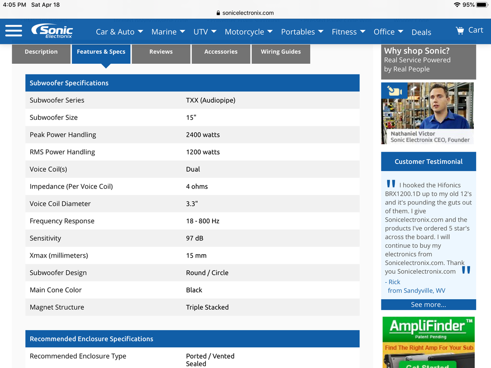

Ron it’s TXX-BD3-15...I have photos of speaker and box with specs but am having trouble posting pics ...sorry new to this lol
Is it a dual 4 ohm version or the dual 2 ohm version? And what’s your budget on an amp and an enclosure for the subwoofer? Once I know these factors then I can help.

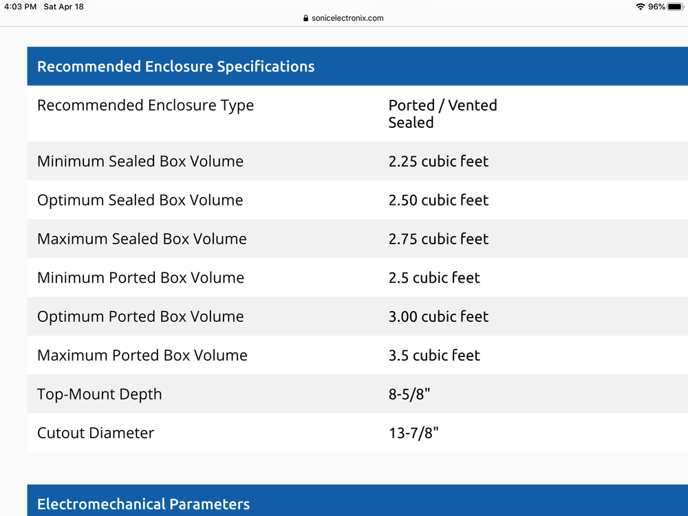

These are the specs , Help her out guys. If your on a budget Skar Audio RP 1200.1 or 1500.1 will do great. For box looks like you need 3cubes , If your just looking for loud bass would just buy a prefab box.

Most likely that subwoofer is a dual 4 ohm. Those amps you recommended wouldn’t be ideal for a dual 4 ohm subwoofer. A 2 ohm amp would be ideal. Most of them subwoofers are dual 4 ohm. That subwoofer is most likely a dual 4 ohm version so a 2 ohm amp would be needed, not a 1 ohm amp. When you google that subwoofer most you will see is dual 4ohm. Even the one on sonicelectronix is dual 4ohm as you can see in the picture.
