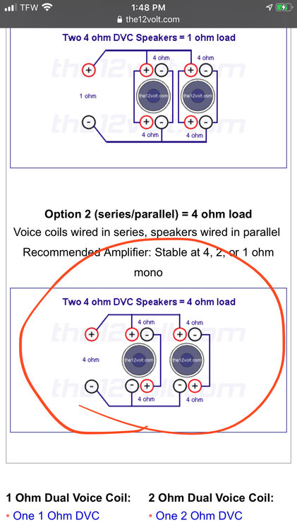

-Subs are wired together to push out a 4ohm load in bridged mode

ive also included a photo of the wiring I’m using
