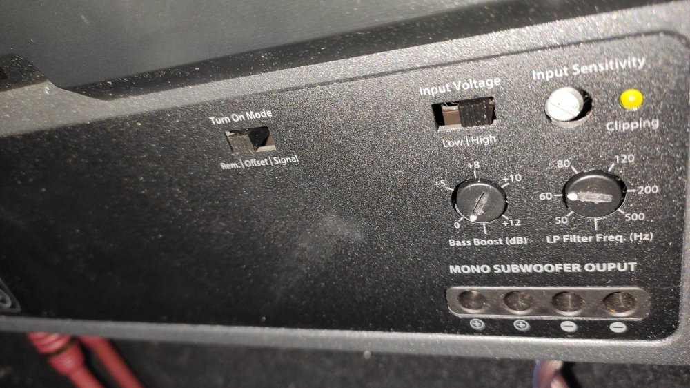

AaronT Posted May 15, 2020 Report Posted May 15, 2020 Please take a picture of all the settings on the amplifier

AaronT Posted May 16, 2020 Report Posted May 16, 2020 I honestly believe you got a overlooked setting somewhere. Because the crossovers should work better the further apart thier filters are set. As you being then closer together, you get phase issues. The way a crussiver works is it just gets certain signals out of phase 180° (at least my understanding) to filter them I may be incorrect in my understanding of the exact method used to filter, but I'm positive if I see your amp settings I could iron this out as long as both deck and amp aren't messed up in some way.
Qwiz Posted May 16, 2020 Author Report Posted May 16, 2020 Here's a pic. After some other testing done today I can surely conclude that, after moving the sub back in the trunk it still sounds muddy. When it was n the back seat it sounded clearer but still sloppy/muddy so I think there is an underlying problem here. I am very eager to find out what it is and it will be a blessing to know it. EDIT: The input voltage is set on high because according to the manual, if it's set on Low you have this Gain voltage Range 2V - 200mV, while on High 8V - 800mV. I know according to a testing video from FiveStarCarStereo on YT that the PRS outputs a clean signal of 4,9V with SLA +3 on the USB which I use most often. So I know at close to max volume I would have an output greater than 2V, that is why it is set to High. If its set to Low it sounds crappier anyway, or at least the same crap degree. The box is as I stated constructed to the exact parameters the JL w3v3 needs, heck, it's even from JL too. I have even taken the sub out of the box and listen to it in free air and guess what it OUTPUTS THE SAME MUDDY BASS SIGNAL WHAT THE HELL IS GOING ON GUYS????
AaronT Posted May 16, 2020 Report Posted May 16, 2020 1 hour ago, Qwiz said: Here's a pic. After some other testing done today I can surely conclude that, after moving the sub back in the trunk it still sounds muddy. When it was n the back seat it sounded clearer but still sloppy/muddy so I think there is an underlying problem here. I am very eager to find out what it is and it will be a blessing to know it. EDIT: The input voltage is set on high because according to the manual, if it's set on Low you have this Gain voltage Range 2V - 200mV, while on High 8V - 800mV. I know according to a testing video from FiveStarCarStereo on YT that the PRS outputs a clean signal of 4,9V with SLA +3 on the USB which I use most often. So I know at close to max volume I would have an output greater than 2V, that is why it is set to High. If its set to Low it sounds crappier anyway, or at least the same crap degree. The box is as I stated constructed to the exact parameters the JL w3v3 needs, heck, it's even from JL too. I have even taken the sub out of the box and listen to it in free air and guess what it OUTPUTS THE SAME MUDDY BASS SIGNAL WHAT THE HELL IS GOING ON GUYS???? You ready for a simple solution to your problem? Input sensitivity switch position. You put it on high-level input if you're using speaker wire to feed your amp signal. If you are using RCA's you set it on Low Give that a shot and call me In the morning

AaronT Posted May 17, 2020 Report Posted May 17, 2020 You could have very possibly ruined that amplifier with that switch in that position when using RCA
AaronT Posted May 17, 2020 Report Posted May 17, 2020 16 hours ago, Qwiz said: With the Switch on Low the Gain must be re-set to a lowerer position counter clockwise, but it still sounds nasty. I will re check tomorrow but then again I expect no improvement. I keep having the feeling I am not having enough pressure although the sub is really exerting some excursion and air seems to flow enough, still I don't get that bass feeling, in terms of feeling but also not getting the sound in your ears feeling, it is a feeling which is pleasant even at higher volumes, kind of another type of pressure. Edit: Why is that switch even relevant, you still get almost the same range with it on High, only the sensivity knob changes. And why is that also relevant as long as the gain sensivity is properly set every time with the help of the clipping indicator and a 40hz sinewave at 0db at max unclipped Hu signal explain that to me please It is because it's there it's there for a reason and that's why it's relevant that's a specific function that it performs.

AaronT Posted May 17, 2020 Report Posted May 17, 2020 SLA is source leval adjustment. All these things will get signal dirty sooner in volume leval. I think you might have pushed that amp too far with not knowing exactly what your settings were and something inside of it has given up or is on its way out. in the past when I was younger I had and that I fucking just literally raped with bass boost and input level adjustments from locs.and when those amps finally gave up they still played but they didn't play right they fucking were like just moving the speakers and making a hollow sound I mean it was Bass the average human being would say hey that's a base system but it wasn't nothing what it was before the amp fucked up
