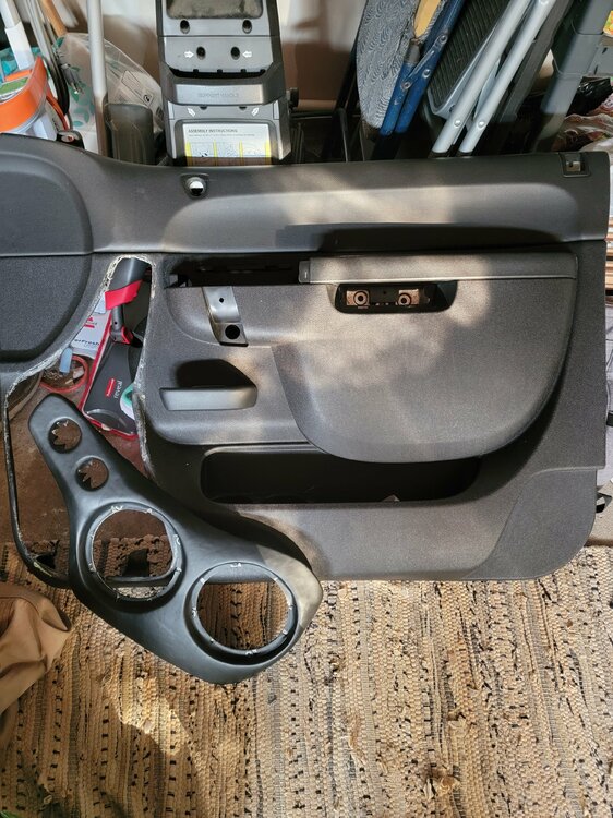

Today, I got a little done. My truck interior plastic is all back together and all the speaker wire is torn out. I decided to start on messing with my doors.
I started by taking off the door panel again. I'm tired of brackets breaking lol. Oh well. First picture I ripped off the existing fiberglass speaker pods from my old build. Literally, just ripped them off lol.

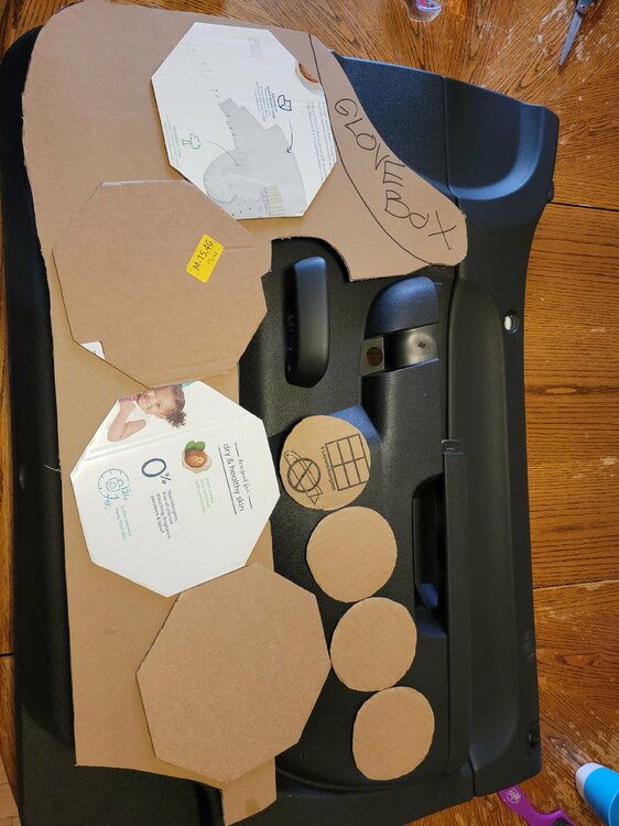

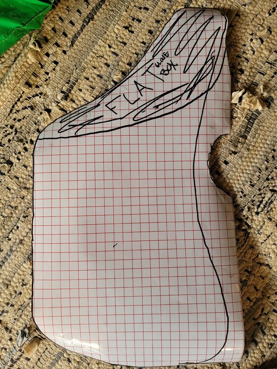

Second picture I made a stencil of that area out of sticky sticker paper my wife has for her arts and crafts. I'll transfer it over to thick cardboard once I'm finished. That colored part at the top is where my glove box comes down. With the old pods, I couldn't open my glove box while the door was closed and that always pissed me off. I've got to cover the hole in the door panel, but it will be a flat as I can make it so I can use my glove box.

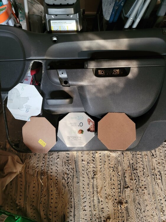

Third picture is of some stencils I made of my 8's. I didn't want to try to fit where the 8's where going to go with the actual speaker so I made those. If be livid if I was trying screw with my door and something happened to my speaker lol. Right now, I'm working on 4 more stencils for the tweeters as well.
I have no idea what I'm doing, I'm just winging it lol. Any pointers, tips, or put downs are always welcomed.

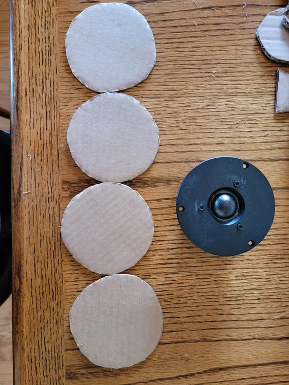

Templates for the tweeters are done. Next I'm going to make a cut template for the door panel. I have no idea what I can and what I shouldn't cut it off by door panel....I guess we'll find out 🤣 I'm not cutting anything yet, just deciding on how exactly to go about doing this
So yeah.... maybe it will work🤣
At this point, I could use any and all tips any of you have a far as placement, a plan, how to cut, what to cut.... anything! I'm starting to feel very overwhelmed.

The mock-up is looking good.  The biggest suggestion comes more in the form of a question - how hard would it be for you to lay your hands on a virgin set of door skins (maybe junkyard pulls?)  Knowing you have a backup set of door cards can go a long way towards calming the nerves.
Another thought - have you seen the Bass Van doors Sound Man is spending years working on?  I'm not super familiar with the interior of late model GM/Chevy trucks, but I wonder if you could maybe do something similar to what he has put together.  Then you could work on building out the bulk of it using 3/8 or 1/2" MDF and then bondo-glass and body work it onto-into the door skin?  Not sure if that would be easier or not.
I can't wait to see the first fab shots, your truck is going to epic when you get finished with it!
