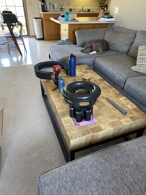

Jacob.Hansen Posted June 15, 2020 Author Report Posted June 15, 2020 Well, after a month and a half she’s here
