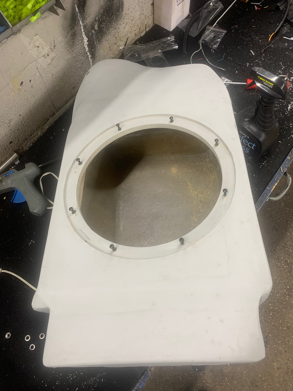

What should I used to fill excess enclosure volume?
My sub only requires .75 cube (sealed)

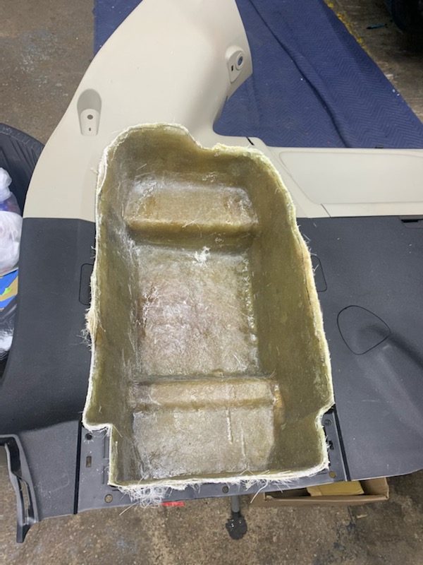

I have yet to actually figure out the volume of my fiberglass enclosure, but I'm pretty sure it's probably closer to a full cube or more.
Wondering if the shape of the blocks I use to take up space and positioning will matter at all?
I've seen everything from baby building blocks, triangle wedges, wooden spheres and even tennis balls used to fill the void on other builds, but not sure if any of this makes a difference in a sealed enclosure image.gif.12b399babc0d1440d75c54cfcc2067d9.gif

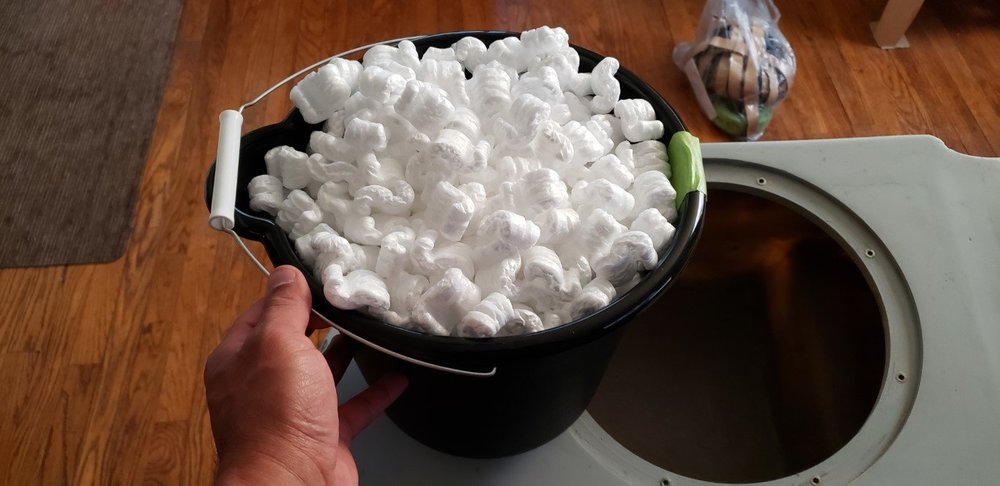

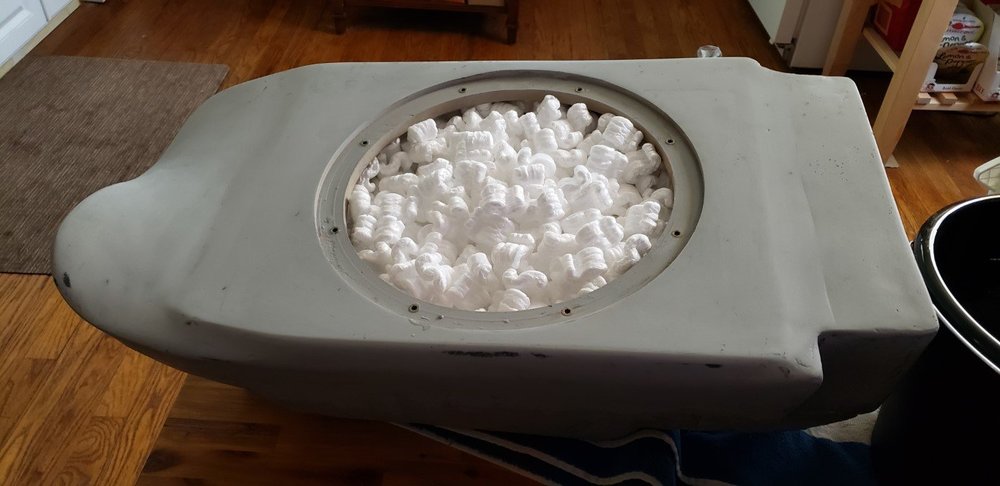

Yeah, I was actually way off thinking it was 1cf or larger 🤔
After a little rough calculation with packing peanuts, it's actually somewhere around ~0.77-0.80cf 😯

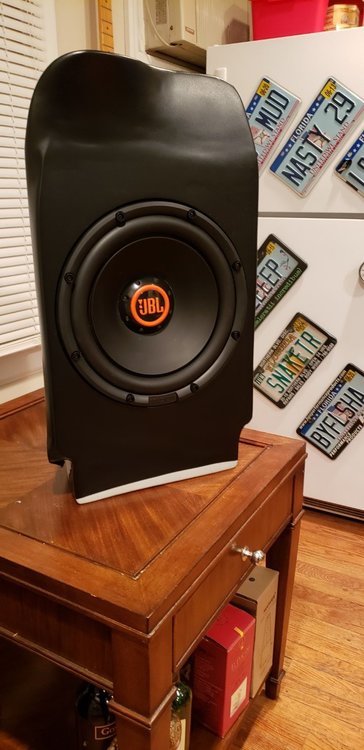

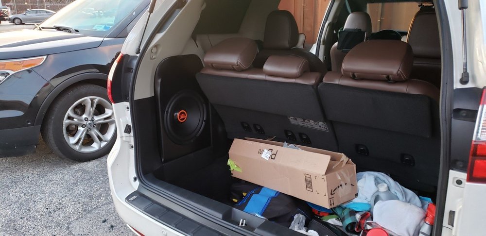

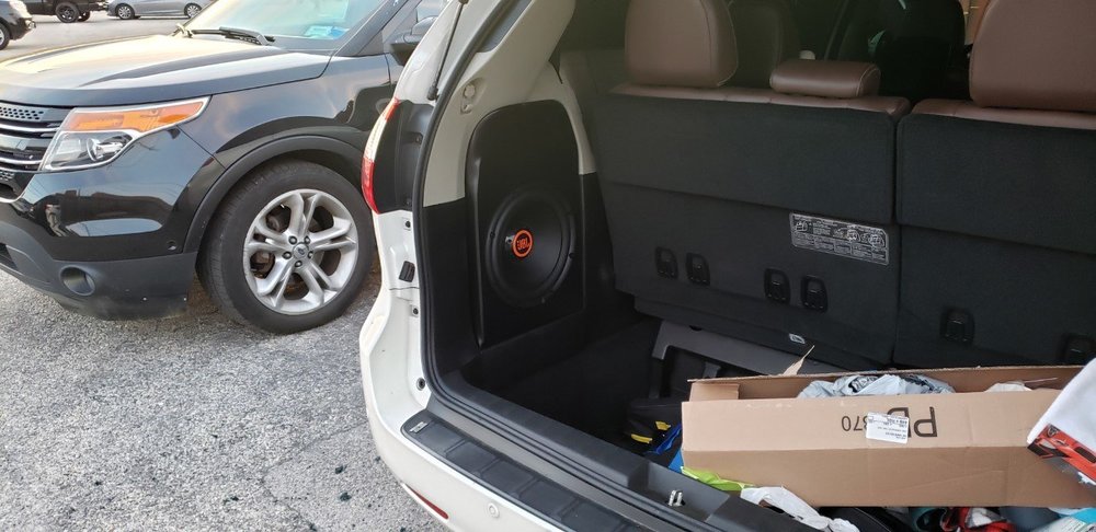

Wired it up and did a test fit
Still gotta color match to the interior and figure out a proper way to secure it cleanly, but it bumps pretty good
