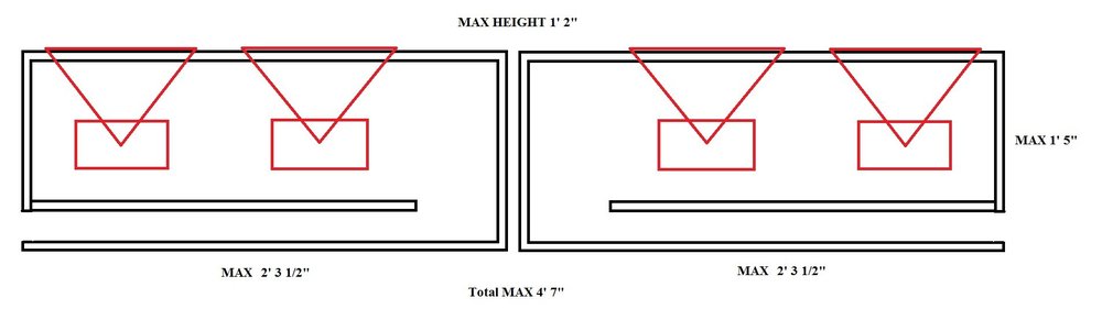

12V71 Posted June 8, 2020 Report Posted June 8, 2020 Not really happy with the performance of these old 12s and want to do something new. All Input is appreciated for a large extended cab truck. Notes: SQL focused Budget 700 for subs Power 1000 RMS at 2 ohm (amp can not run at 1 ohm and not buying another amp) Need to face subs in a way that can accommodate the amps Facing Back is the best current sound (tried forward, up, down, left, right) Really would like 4 10s they have been better to me in similar applications Picture of space MAX dimensions included with proposed design I have allowed an additional 3" on each side for ports
1point21gigawatts Posted June 8, 2020 Report Posted June 8, 2020 You’re not happy with you subwoofers and enclosure because of the way it’s facing. Face the subwoofers up and you will smile. “How can we help you?” “And don’t forget to tell them that the customer isn’t always right.”
12V71 Posted June 8, 2020 Author Report Posted June 8, 2020 4 minutes ago, 1point21gigawatts said: You’re not happy with you subwoofers and enclosure because of the way it’s facing. Face the subwoofers up and you will smile. I did face them every way possible and this works the best for them,. I would like to start over with new subs and new boxes open to any configuration that will work the best, last 4 10s in a truck i had was facing up and ports to the side. it rocked, wish i could get 4 old school boston pro series
1point21gigawatts Posted June 8, 2020 Report Posted June 8, 2020 That’s what I’d recommend, subs up, ports facing each side. Getting new subwoofers will do very little for you when it comes to improvement. Building a better enclosure is the main thing you need to worry about for any type of output gain if you don’t want to upgrade your amp. There’s no need to upgrade your subwoofers if you’re not upgrading your amp. Pointless and there will be minimal gain. The enclosure if done correctly will make that system sound twice as loud and twice as good. “How can we help you?” “And don’t forget to tell them that the customer isn’t always right.”

1point21gigawatts Posted June 8, 2020 Report Posted June 8, 2020 Ok so that’s how you want it, not how you have it. I guess I was confused. Can you build a subwoofer enclosure(s)? “How can we help you?” “And don’t forget to tell them that the customer isn’t always right.”
12V71 Posted June 8, 2020 Author Report Posted June 8, 2020 I can make anything, these fit the budget what do you think? Skar 10-inch Dual 4 Ohm Voice Coil Configuration Peak Power: 1,200 Watts RMS Power: 600 Watts Competition Grade Pressed Paper Cone High Roll Foam Surround Advanced Air Flow Cooling System 2.5" High Temperature Copper Voice Coil Motor Weight: 97 oz Frequency Response: 28 - 300 Hz Sensitivity: 82.5 dB Fs: 39 Hz Re: Dual 4 Ω Qms: 6.08 Qes: 0.68 Qts: 0.61 Mms: 188.75 gr Nref: 0.126% Cms: 0.079 mm/N Bl: 10.9 n/a Vas: 11 L Sd: 298.65 cm² Xmax: 13.5 mm
1point21gigawatts Posted June 8, 2020 Report Posted June 8, 2020 Why do you want to go from 12s to 10s? That would decrease output. I can help you with an enclosure design either way but idk why you want to downgrade in size/cone area. “How can we help you?” “And don’t forget to tell them that the customer isn’t always right.”
