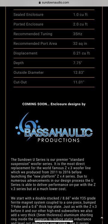

According to sundown, the u sub and the zv3 sub must be used in small enclosure it actually says this on the zv3 12 product page on their site. They also said the u series sub takes the exact same box as the sa12...to my knowledge people usually do 1.75 to 2 cubes on an sa12..never seen anyone go bigger.  I did find a few posts about using more than 2 cubes on a zv3 12 and he said he hit the backplate easily on low power when he went up to 2.25net so he suggested what the owner of sundown suggested .. 1.5 to 2 cubes with 1.75 and below being what he prefers.
Plus the tech at sundown told me to go 1.75 at 36hz. So u see why im so hesitant to go bigger than 2net..not saying it wont work but...just hesitant....
Also if i go ahead and do it and rip 2k on a oversized box im worried i may damage the sub by over excursion or bottoming it out rapidly and easily..
Sorry for being so hesitant but tryin to be safe..

The sundown u subwoofer and the zv3 are about the same subwoofer. Not like the sa series, not the same enclosure recommendations. The sa call for 1.75 cubic feet and the u series calls for 2 cubic feet and on each of the subwoofers I would go a little bigger than recommended. That 2.2 cubic foot design isn’t too big. Sundown allows for up to a 25% increase. You can do so on more rms than rated too because of impedance rise and plus sundown subwoofers can handle more than than rated even after rise. That tech is just a tech and they are not a designer. They never recommend over manufacturing  recommendations for warranty reasons. They are just techs. You see what yielded from that port area calculator when you used such a small enclosure on that much rms. Plus when I ran the numbers, it didn’t yield well. So 2-2.5 cubic feet would be the best bet and that’s what was yielding well. And now look at the sundown u series 12” subwoofer recommendations and the brief description.
