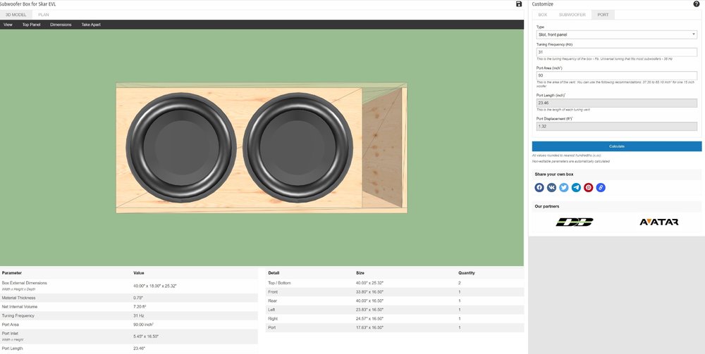

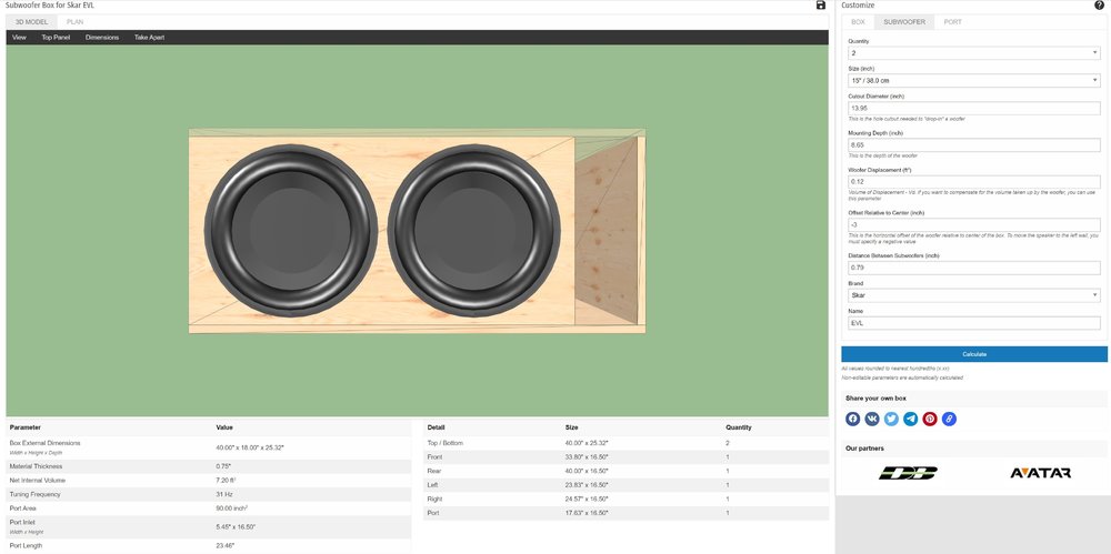

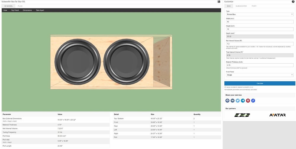

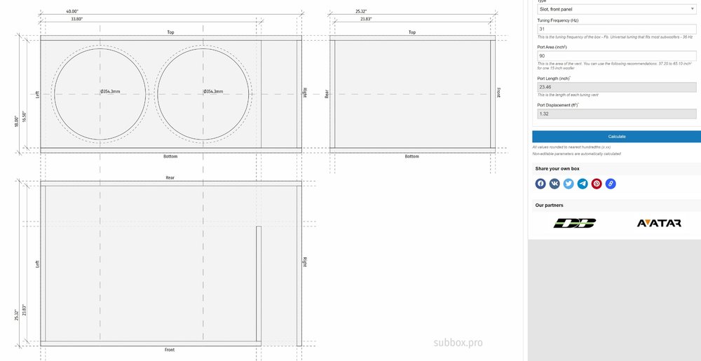

Hey Taxed1, I took care of that for you. I did leave a little extra for height and width, and your depth (the parameter that the calculator adjusts for you) was considerably shallower, to give you more space.
Here are screen shots of everything you would need. Personally speaking, I'd probably add a little depth, to account for bracing, which I would definitely add to the single thickness (3/4") panels. But there are so many ways to do this, that is going to be up to you. If we discuss what your going to do here, I can tell you how much extra to add to the depth. But you can add quite a bit of bracing with only maybe 1" extra depth.
Anyway, I'd be super confident in this design. Exactly what Skar calls for. Oh....... but would you consider yourself more of a "LOUD" bass guy ? ...or a DEEP bass guy ? Skar recommends a 31 hz tuning.... which is pretty darn low (and would feel really good ;) ) ....but if you lean towards more loud and obnoxious (:) lol) you could tune it to say 34 or 35 for a few extra dB's, but at a small cost to depth, and air movement.
This program is pretty cool, and free. It has a few little things that bug me, but generally speaking, it works well, and is pretty straight forward..... in case you want to play with it yourself.
https://subbox.pro/en/design/?bt=2&bw=1016&bh=457.2&bv=203.9&mt=19&fp=1&sq=2&ss=15&cd=354.3&md=219.7&sv=3.4&so=-76.2&sd=20&sb=75&sn=EVL&pt=4&pq=1&rf=31&pd=271.98&pw=2&pa=580.68&pp=100
PS, No matter what you decide, I highly recommend that you make a cardboard mock up of the exact same size as the plans call for, to make absolutely sure it will go in, and fit well, and clear your trunk hinges and such BEFORE committing. Oh, also, on those board cuts that end in .74.... .75 is close enough :) Don't want to screw the lumbar yard guys all up :) lol
PPS,  Important ! For whatever dumb reason, it would not let me add a double thick baffle ? But if you go with this plan, you would need one extra board of 40" x 18" (not 40 x 16.5... as it will lay over the whole front, including the joints at the top and bottom)
I think if you give this thing 2500 or 3000 watts, it will slap ;)
