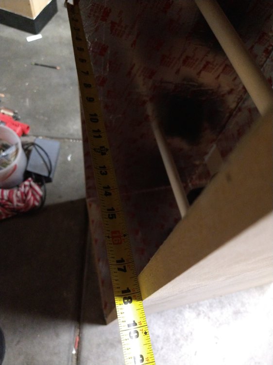

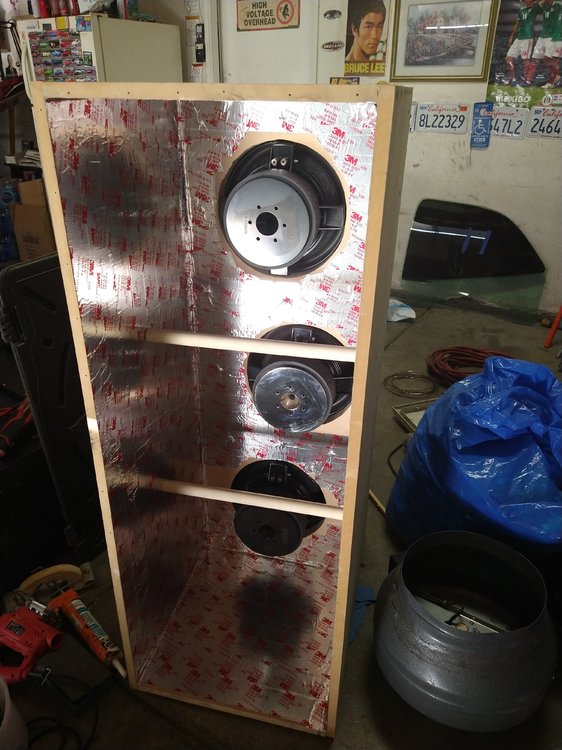

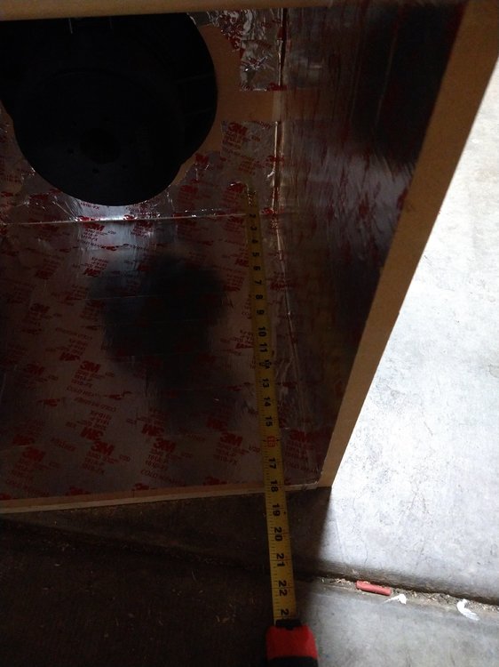

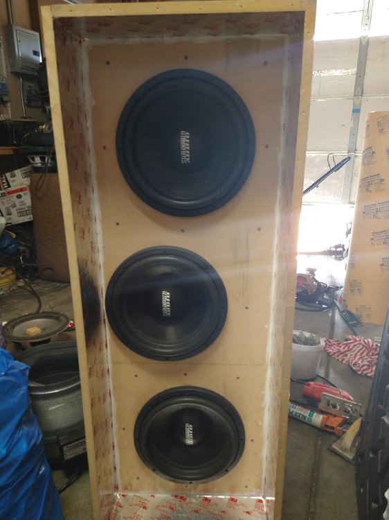

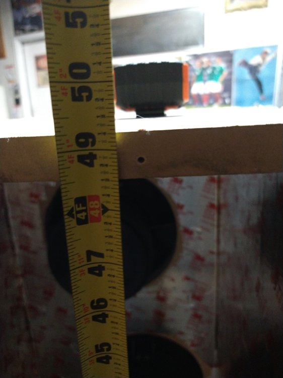

Are you sure that front section is only 8.5 cubic feet? What are measurements of the outside of that front sections depth to the middle of the double baffle? So I can calculate the front section’s volume. Not saying anything bad or that you are wrong or anything like that. I just want to double check. And are the subwoofer magnets gonna be in the front ported section or the rear sealed section? And is there any bracing?

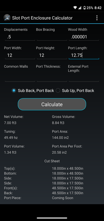

Optimal port measurements.
inside width-12”
outside width-13.5”
inside height-12”
outside height-13.5”
Port length-12.75” (0.75” front board measurement is included in the port length measurement if you are making the port external. Measuring the length inside the port is the correct way to measure)
tuning-45.14hz
144sq” of port area
17.13sq” of port area per cubic foot
