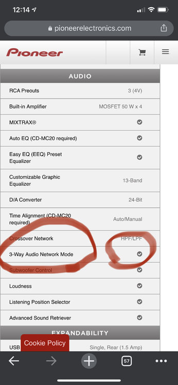

Morgan_Meigs Posted September 10, 2020 Author Report Posted September 10, 2020 6 hours ago, PaperNoFlavors said: I have a very similar setup (for your new setup) I have 2 FSX65 in the doors along with 2 bullet tweeters from skar. I am running them active (no passive crossover box) on a skar rp.1000 4 channel. The rp.1000 has a band pass filter so you can set the range on channel 1&2 and 3&4. (SMD makes a tool to dial this in) however I went with a Kenwood Dmx706s which has a DSP and 3-way crossovers built in. For this reason, everything is set right on my head unit, and my amp is set to full. Makes for very precise and dynamic range. (Plus it’s easier to setup) I do have bass block capacitors connected to my tweeters so they will not play anything under 4k (just incase something fails or the speakers pop when amps are turned on) just a thought here... if you do not want to upgrade your HU just go with an amp with a band pass filter and run your tweeters on channel 3-4 and doors on 1-2. I had the skar components you have in your current build and I felt they sounded very washed out and not warm at all (kinda harsh at full volume) I did run the TX65 in this same setup active with the bullet tweeters and they sounded beautiful! One thing to take into account is that passive crossovers can eat up to 40% of the power before delivering it to your speakers. So if you run passive, you will basically need an amp that can supply 3x your speaker rating. Active is the way to go for sure. hope this helps! I have a Pioneer MVH1400NEX. Would this have a DSP and the same x over system?
PaperNoFlavors Posted September 10, 2020 Report Posted September 10, 2020 1 hour ago, Morgan_Meigs said: I have a Pioneer MVH1400NEX. Would this have a DSP and the same x over system? Honestly, I don’t use the dsp with my setup. A external DSP (not in HU) allows you to set the exact x over points much like my head unit. You have some big options here. 1. You go with a Audio Control amp that has a DSP/over you set via Bluetooth on your computer (good this and check it out) they are pretty expensive though. 2. You do a similar setup to mine. 3. (Most budget option without SMD TOOLS). You use the rp.1000 bandpass filter that’s lets you control the xover with knobs on the amp. And you keep the HU you have now. If you went this route I would look into getting a SMD DD-1 (about $200) and set your crossover points with it (does it to the exact freq.) and certainly look into a SMD - DD1 so you will not have distortion (another $200) this is where it gets expensive to fine tune things. The DSP on my head unit (separate from a 3 way xover built in) allows you to delay the speakers playing by milliseconds based on how far away you are from the speaker. (So it doesn’t sound like you hear your left driver speakers more) if you went with option 2 you would spend about $400 on the H/U but would have everything right there. Make sure if you go this route you choose an (Exelon model) so it will have 3 way mode (networking mode) this was actually my first build and obv I learned a lot. However you do get to the point of spending some serious money, so really consider what you are going for. I took the h/u option for my X overs because I knew the H/u will hold its value and have a larger market than the audio control amp, if I ever got a new vehicle and needed to start over. OKAY, So I just looked up your HU and it does have networking mode. I’m going to leave the other details up for anyone in the future. See attached specs on your HU
