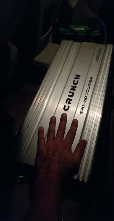

Holy crap. I need to purchase an alternator upgrade quick. This thing is smashing my electrical. I got this amp rebuilt, and I have it only a quarter of the way up at 1ohm. It isn't shutting off anymore. But I tested it with a meter and i was having voltage drop to below 9v! No wonder it was going into protect. As of right now I have my meter wired in so I can watch it and make sure I stay above 12 volts.  It still slams really well, but I can def pull a lot more ot of this setup. I just need to get an alt upgrade like suggested. Guess I'll start saving! Luckily the alt is right on top. Are the high output alts direct bolt on like an oem would be?
I can't wait to get one. I'm barely pushing this amp for now and I can balance a paper towel in my window lol. Sorry a bit excited. Looks like I came across a old school gem! I've included a pic of it.
