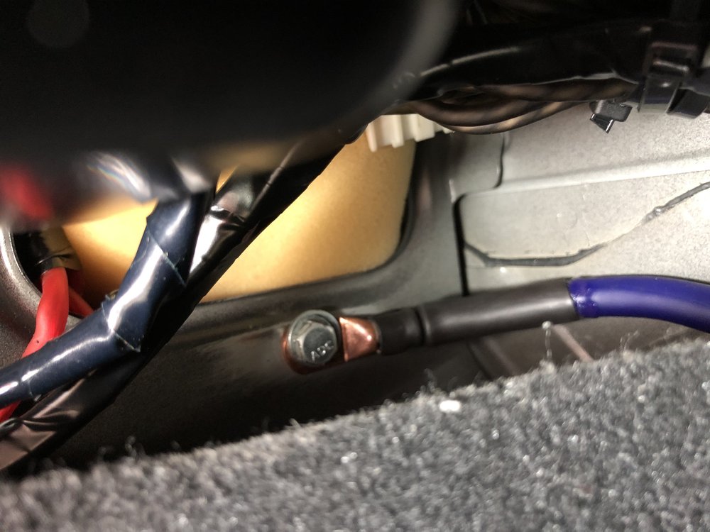

Kennyy Posted September 22, 2020 Author Report Posted September 22, 2020 1 minute ago, 1point21gigawatts said: How are your amps grounded and where? My subwoofer amp is grounded to the literal frame of the car (below the trunk on bare metal), my subwoofer amp has absolutely no issues. my mids and highs amp which is connected to my components is grounded to the rear frame of the car (below the rear bench seat) I attached a picture. All the connections front to back seem perfect and solid, I’m going to go ahead and assume it’s my ground on the amp considering the speakers still make fuzzy static noises when the RCA’s are unplugged (might be a Rookie mistake). My lc2i is grounded straight to the battery as well.
1point21gigawatts Posted September 22, 2020 Report Posted September 22, 2020 If that loc is still in that circuit when you unplug those rca’s then it’s the loc. So you would have to move that loc’s ground from that battery to it’s own grounding location. “How can we help you?” “And don’t forget to tell them that the customer isn’t always right.”
