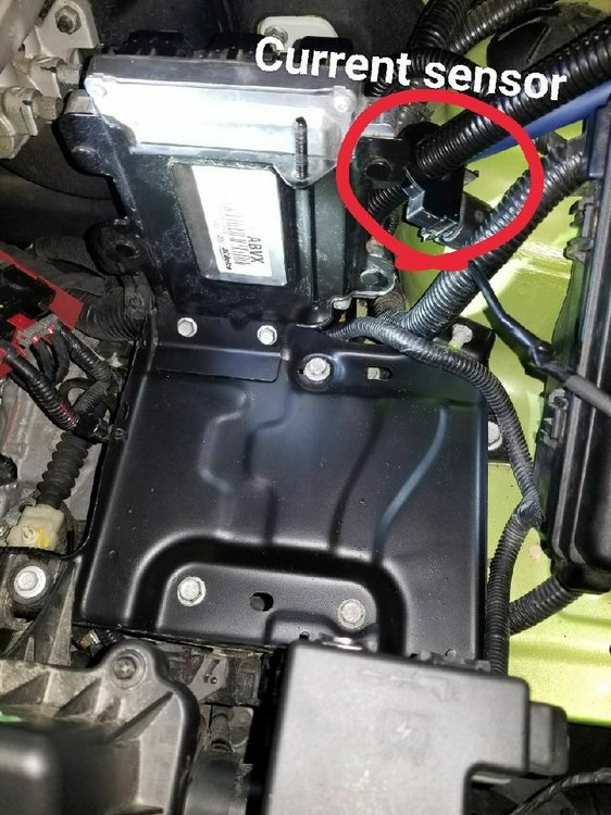

The car does have a battery current sensor...could that be why?
I have positive from the alternator going to the front battery. And front battery + and - parallels to the rear battery. All 1/0. Front battery ground cable is 1/0 with the current sensor. Thankfully, it fits 1/0 stock.  However, im also heavily grounded in the rear. Rear battery grounds to the seatbelt anchor bolt, as well as the 1/0 ground that returns back to the front battery. 1/0 all around.
Electrically great, but it occured to me, any draw on the system ( or that 500F going from 13.8 to 14.5v ) is 100% non existing to that current censor. As, id expect it travels to the frame, and frame to engine/alternator. Fully bypassing that censor. Would this possibly cause an issue, where the engine may idle too-low due to not knowing theres a demanded load happening? Im at a lost if this is my problem, or if my engine is literally just too pissy to handle this alternator when at idles & demanding load.
Note - normal operation with 2 batteries, ive been hammering this system for a year now with zero issues. Very solid voltage. This ONLY came up when i put that 500F bank on and relised the car doesnt start. Then it made me notice the other minor things I never noticed, like idle + make the window go up even tho its already max up, bogs the engine for a second and makes it overshoot rpms before returning back to the 800'ish idle. Im mostly posting this to know if that current sensor being bypassed with rear grounding, is screwing my stuff up..if alternator can be too heavy for an engine.. or if i have another, worst underlying issue.

i unplugged that sensor on my cruze no issues.
