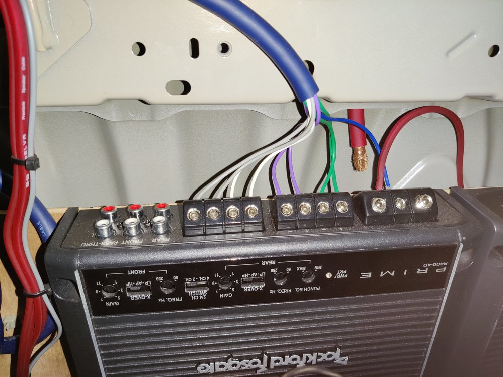

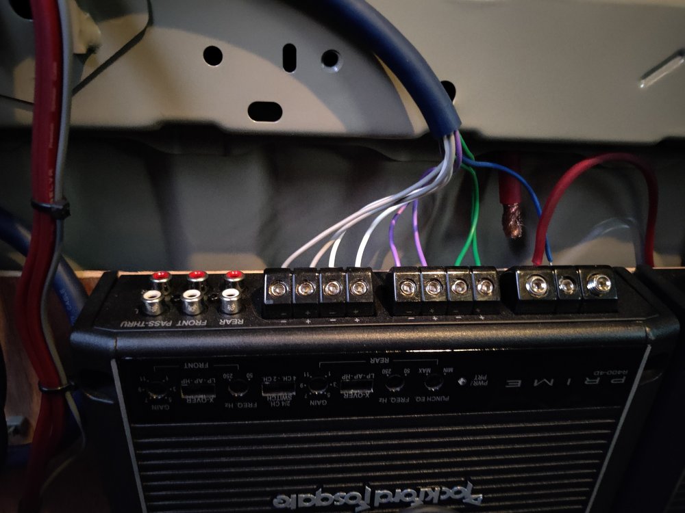

So I have a rockford fosgate r400-4d amp driving four speakers in my tacoma. It's been installed for about 3 years with zero issues and is not abused (still running stock speakers). The other day while driving listening to a podcast at normal volume the amp stopped outputting anything to the speakers. The amp never entered protect mode and still appears to be powered on (solid blue led).
Here is a summary of the setup.
Stock head unit
Line output converter (2channel)
RCA input into the r400-4d (using 2 channel input mode)
I use the RCA passthrough off this amp as the input for my subwoofer amp (which is still getting signal and playing fine?!?)

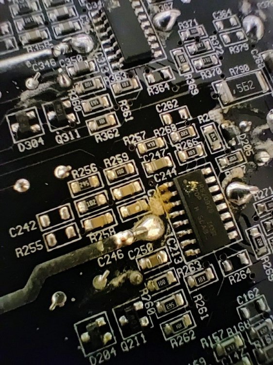

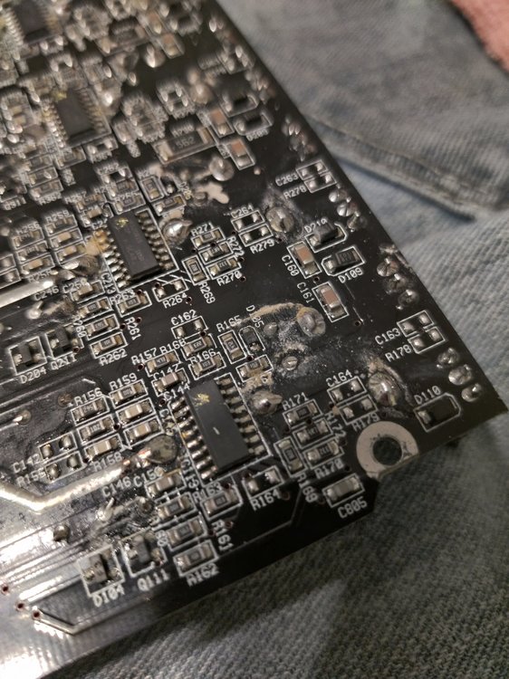

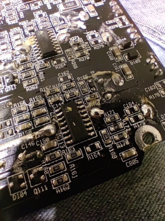

-I pulled the amp out of the truck and took it apart. Everything looks good to me nothing looks burned at least. I took pictures of the dirtiest connections but they seem solid to the board still. The amp never got hot to the touch even when played loud.

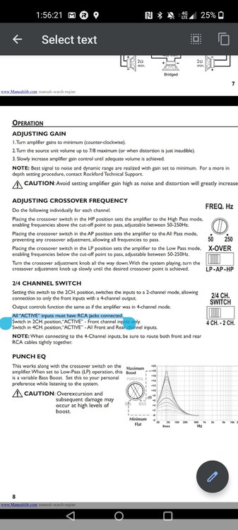

-The only thing I can think is from the owners manual about using 2ch vs 4ch RCA inputs. See screenshot. The 2/4ch switch does seem sticky to me but I don't know if this could be the issue. Worst case the switch is bad and the amp thinks I'm using 4ch inputs but only have the front input connected. Would this really stop any signal from getting into the amp?
-I think I have a way to troubleshoot the 2/4ch switch by simply plugging in 4ch RCA inputs. I'll get the front two from my 2ch loc. and I'll fake the two rear inputs fom the ipad headphone RCA converter.
