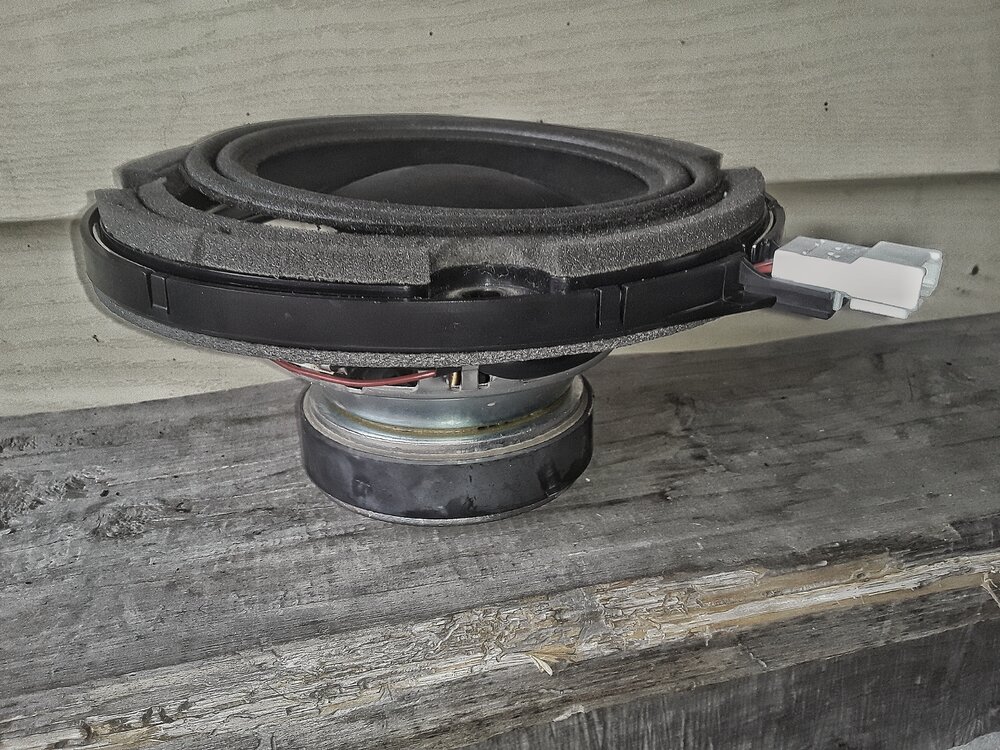

hershy573 Posted January 5, 2021 Author Report Posted January 5, 2021 Spent nearly 7 hours today trying to get the wires ran for the amp. 5 of the hours was trying to access the factory amp so I could disconnect it and splice into the wires going to it. Good news is I have the wires ran to where I want the amp to sit, now I just have to run wires to the doors and dash and install the new speakers. Only 2 days left to get this done thanks to the A-hole old man winter. I'll get it done, even if I'm working by flashlight on wed. night. I pulled the stock sub while I had access to it, I think it's seen better days.

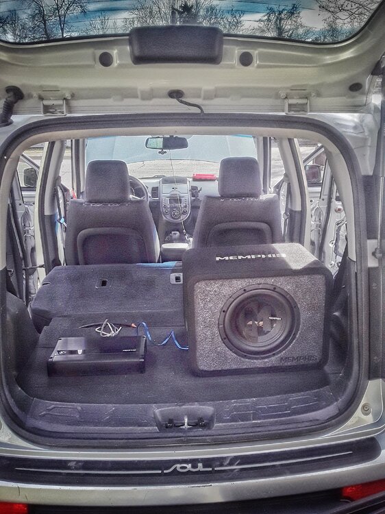

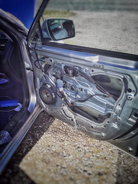

hershy573 Posted January 6, 2021 Author Report Posted January 6, 2021 Today I made a lot of progress on the install. I removed all the stock speakers and ran new wire to each door. Of course with each step forward is two steps back. I don't have the speakers in the doors installed just yet, hopefully tomorrow. I do have the amp wired and sub playing, but that's all so far. When I took the pic the amp wasn't hooked up (clearly) so that's why you can see the ground wire. I really hope to have everything back together tomorrow, cause snow is coming starting tomorrow night and I don't have a garage. Now it's time to rest and figure out what my next move is.
liteblue Posted January 6, 2021 Report Posted January 6, 2021 Very cool progress! The sub is done, put it out to pasture. The new sub and amp look really great. Running new speaker wire to the door is the way to do it, i am just too lazy! Super cool 👍
