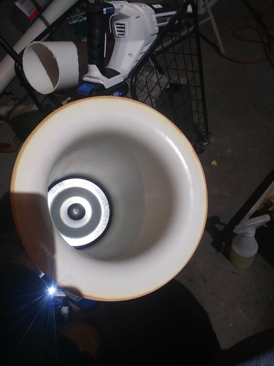

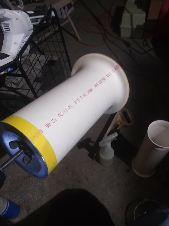

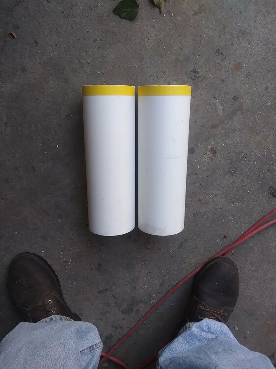

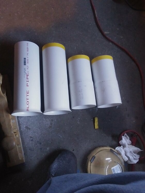

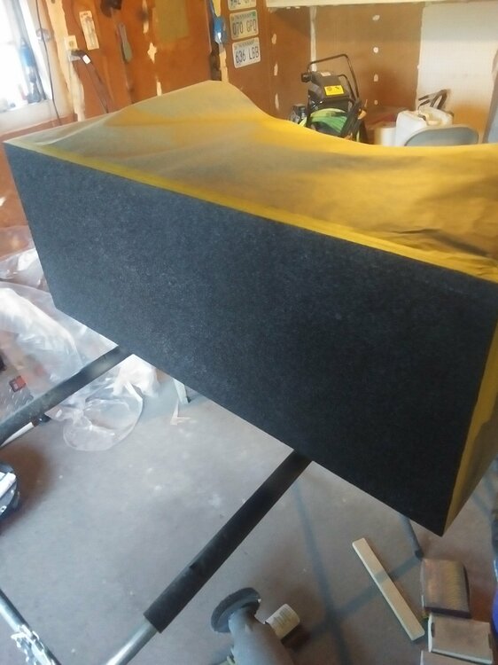

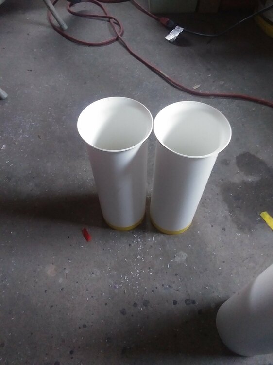

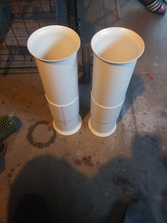

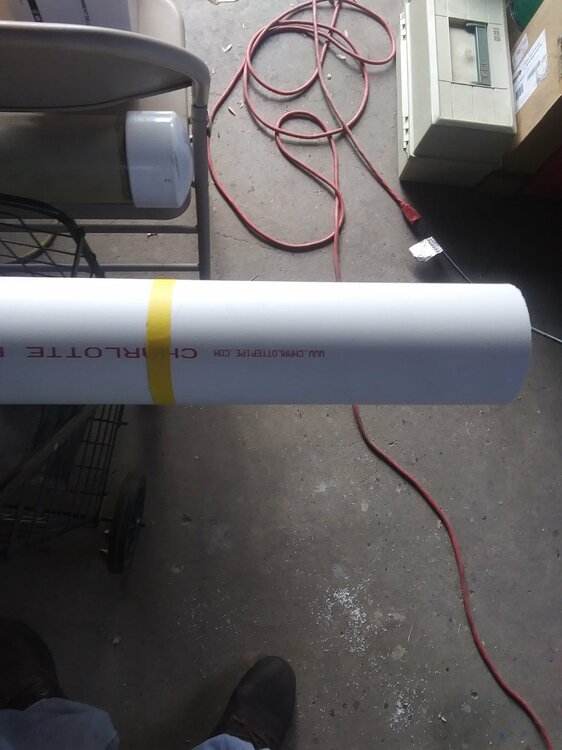

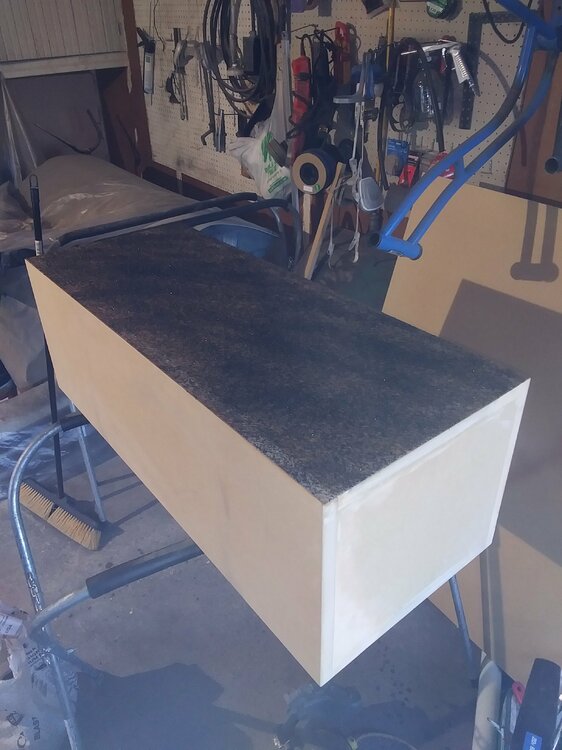

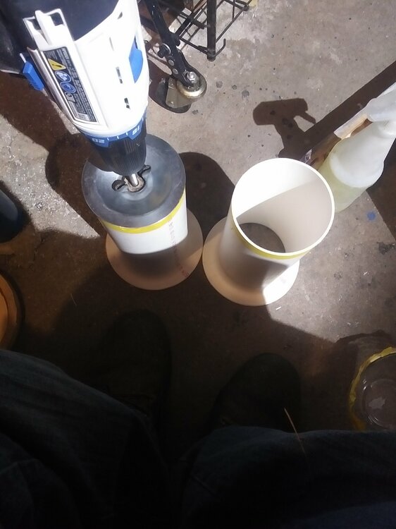

So I got my 4 pvc and I'm ready to flare it and finish up sub enclosure.
I have a couple questions.
1. How important is it to flare the port ends?
2. How do I calculate port length including flared end sections?

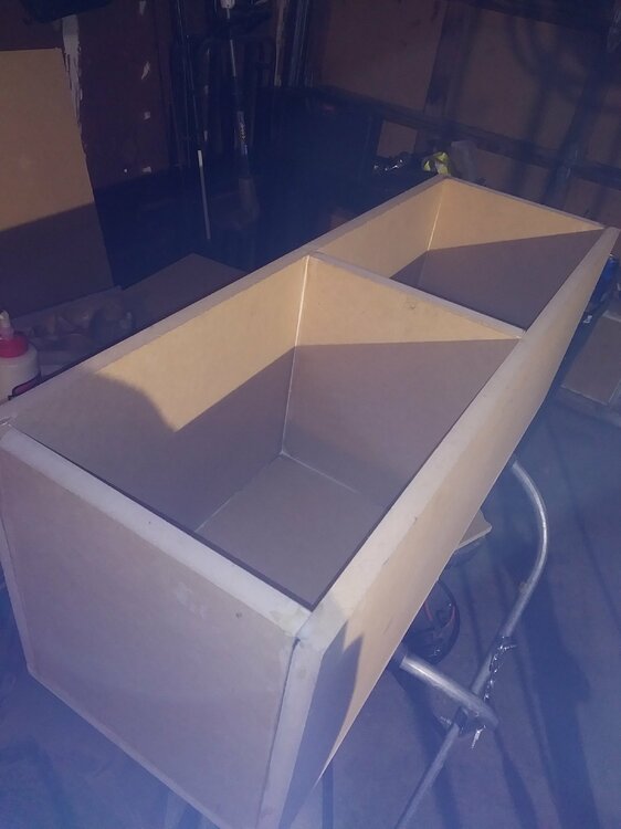

3. How much space do I need between the ports and enclosure walls? Does it matter as long as it doesn't touch? I have to make the ports 12" long and box is only 14 inches deep. So excluding wall thickness that leaves me maybe a 1.25" clearance. Thats before flared ends are added. Unless I
include the flares in 12" total length.

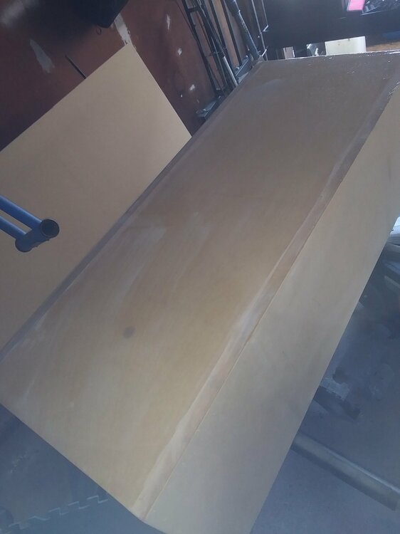

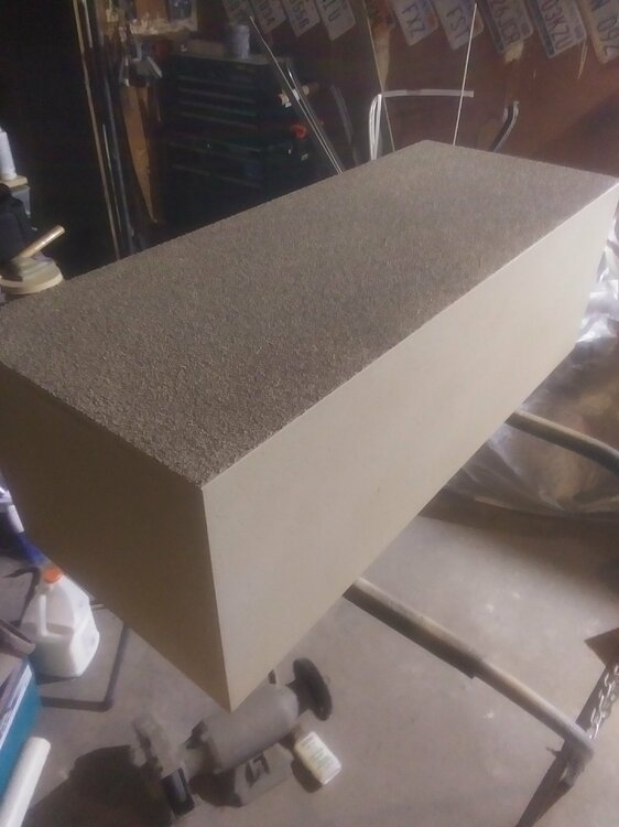

Here's a couple pics so you get the idea. Some are missing so I'll add more tomorrow dont know why I didnt get any of the front.
20201230_214728.thumb.jpg.34ea8951a7a1b958ae305b7168ecb12a.jpg20201219_125550.thumb.jpg.72e1ad9781c904d4ec445ea83c085b66.jpg20201231_211135.thumb.jpg.533b28c1a444547c92d19b3d02802100.jpg20210102_152808.thumb.jpg.93cb5f3d21f36a644d0584cb12d738a4.jpg20210102_213204.thumb.jpg.791b722d0fff14206a56cea7a43af11f.jpg20210103_170030.thumb.jpg.66601ce2d96f8ec067f04d70150de93c.jpg
So im pretty sure I'm mainly talking to myself at this point but if anyone knowledgeable sees this I could use some advice.
So I made the ports at 12" including the flares, I did not make them any bigger because they were so close to the back wall of enclosure. I read a post that said the port needs to be atleast the diameter of the tube away from the back wall or else it will affect tuning(lower).

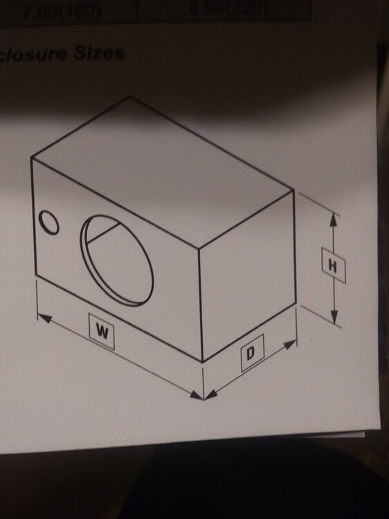

I am confused as this is the recommended enclosure design from manufacturer. Even though I am sure this box will sound great there is too much iffy shit going on here. What should I do go ahead and use it and figure out tuning after or build a new  enclosure?
Also I will be overpowering the subs eventually and did not account for this when designing and building enclosure. Please advise.
