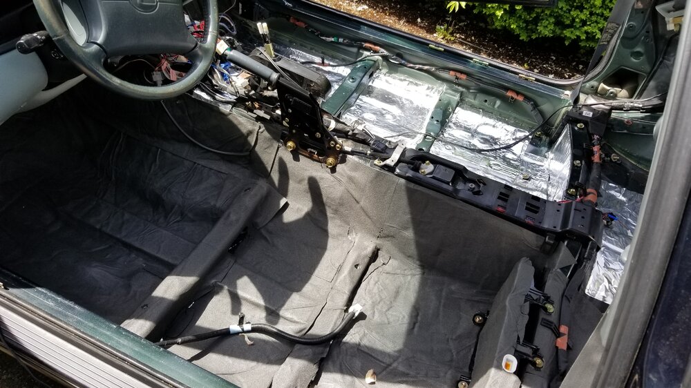

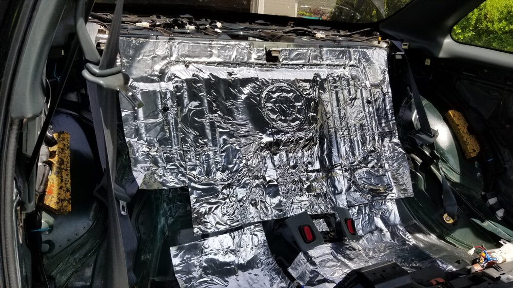

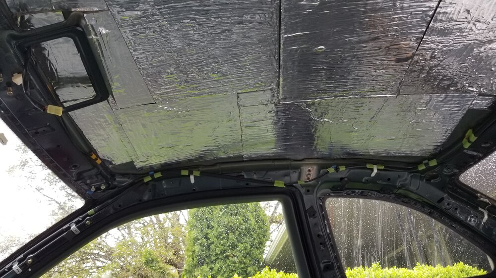

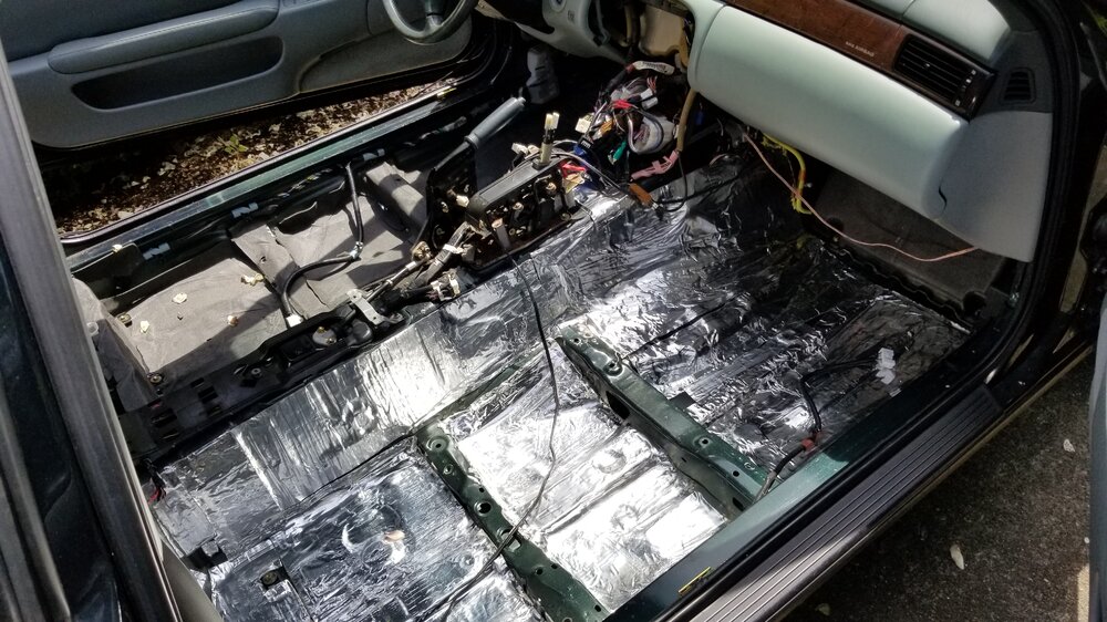

FULL raamat, and ensolite treatment throughout ENTIRE vehicle.

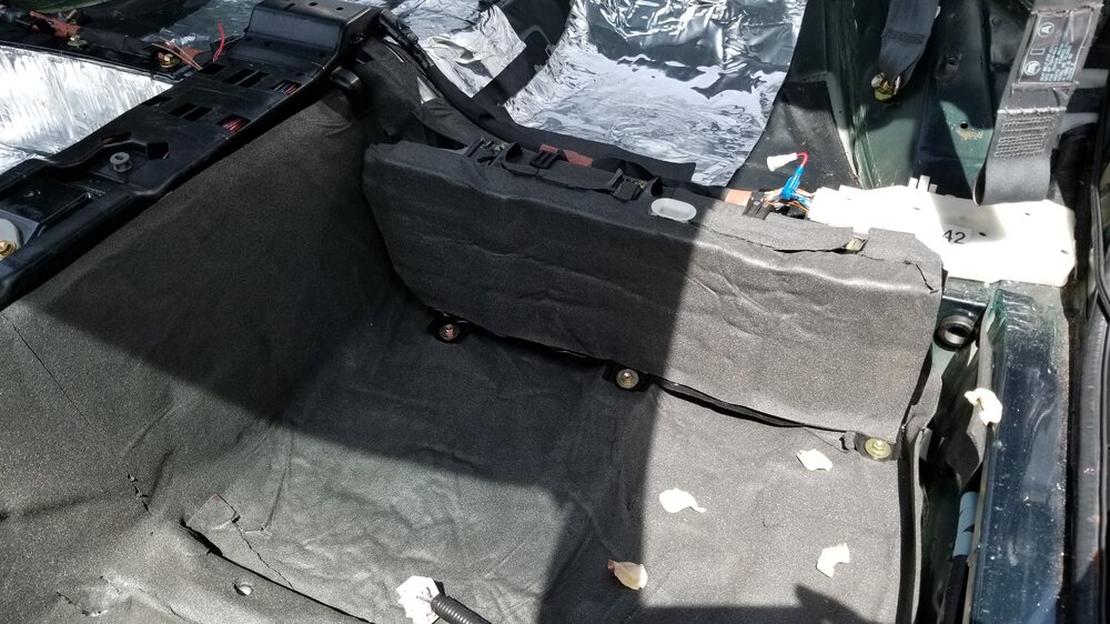

Soooooo, currently I'm running the hx2 in the trunk on a t1000.bdcp amplifier. I feel I am losing tons of bass since the trunk is basically sealed off from the car, and the fuel tank is in between the trunk and the back seat. I have decided to remove the rear seats and put a box in their place.
My plan is to glass the seat tub and back wall for the rear and bottom portions of the box, or boxes. And use 3/4" birch for the remaining faces.

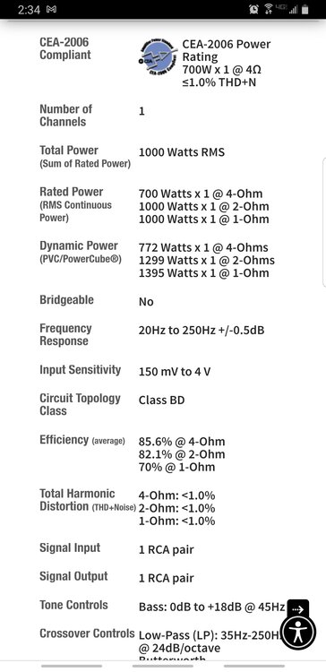

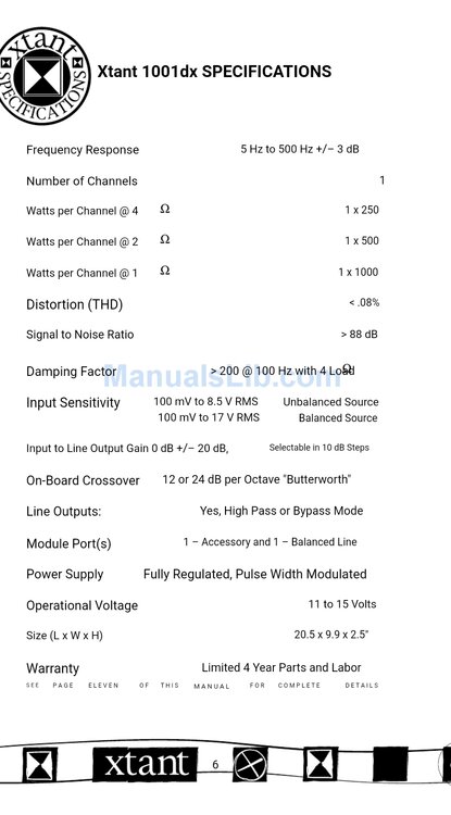

The t1000 is either ~1k watts at 4ohm or ~1.5k at 1 ohm. I don't have the birth sheet, but that's typical of what I've seen for these amp's.
The 1001dx is rated 250 watts at 4ohm or 1k at 1 ohm.
The xtant should put out better sound, and from what I've read they are very underrated on their specs.
