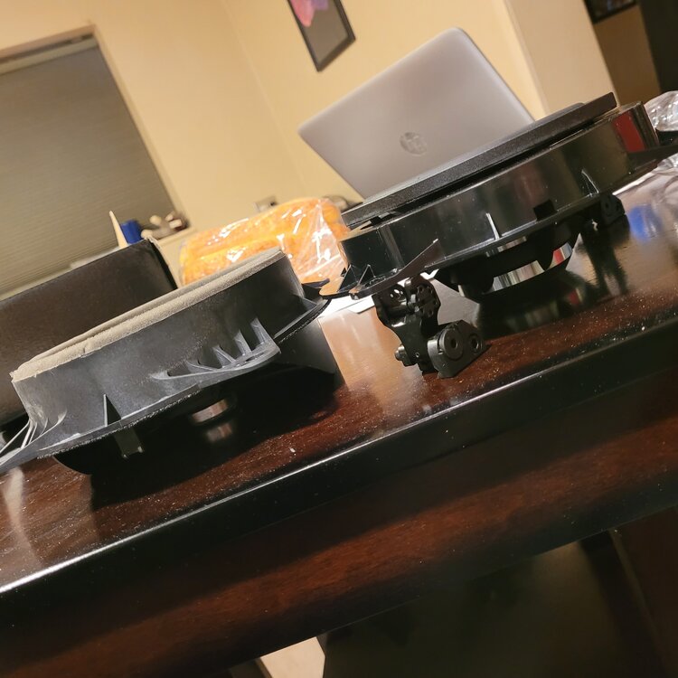

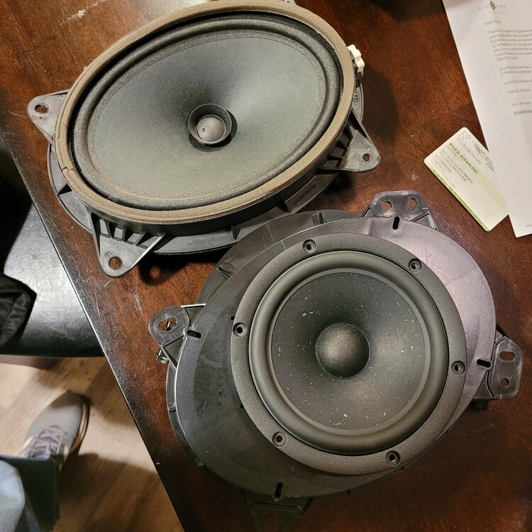

Kyblack76 Posted January 29, 2021 Author Report Posted January 29, 2021 4 hours ago, BassMunky said: How does.it sounds though Just getting started mate..... That said........ SMD SUPER SELLER The Burban Build Blazer Build sold Acura trunk build sold

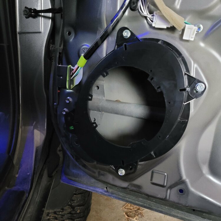

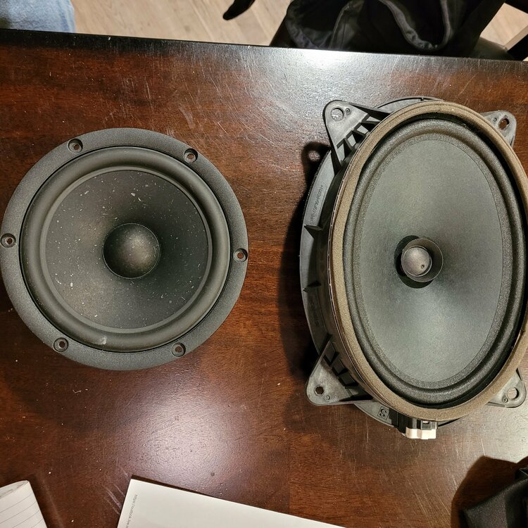

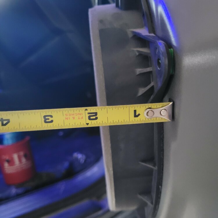

Kyblack76 Posted January 29, 2021 Author Report Posted January 29, 2021 The "please please" portion, is,.. for the love of god,.. please fit, .. fit, and let me not worry about shit, like the window not going down, and all that. SMD SUPER SELLER The Burban Build Blazer Build sold Acura trunk build sold

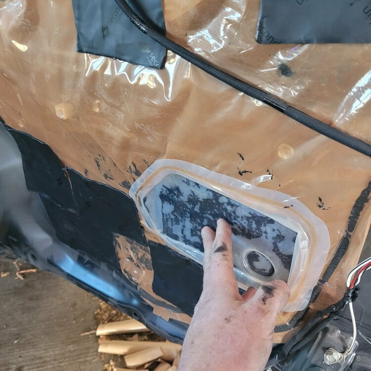

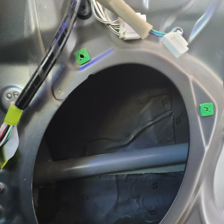

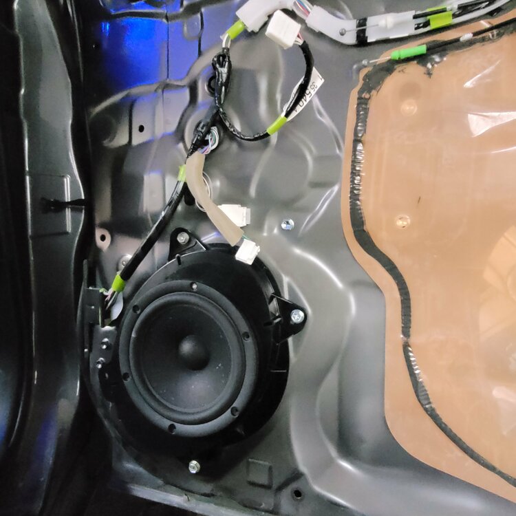

Kyblack76 Posted January 29, 2021 Author Report Posted January 29, 2021 All checks,.. we are good to go,.. first,.. its put Second Skin Damplifer pro, all over everything..... everywhere... here we go. SMD SUPER SELLER The Burban Build Blazer Build sold Acura trunk build sold
Kyblack76 Posted January 31, 2021 Author Report Posted January 31, 2021 About 4lbs of Second Skin,... on one door (pass side)... Also, any, and all OEM holes, are filled, mostly on the back, as, with rigs like this (my acura was the same way) they are built, pretty well, and if you add any thinkness, to the outter, the panel wont fit. That said, you HAVE to watch the inner also, becuase, shits so tight, your window mech may not function, but ... one door down,.... SMD SUPER SELLER The Burban Build Blazer Build sold Acura trunk build sold

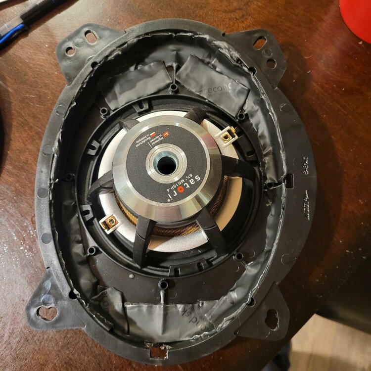

Kyblack76 Posted January 31, 2021 Author Report Posted January 31, 2021 Dunno if anyone else does this shit, but i love adding weight/second skin to any after market shit to..... Just make it ALL dead/dense as fuck. Man, i love this Second Skin.. shit sticks like a mother, and is easy to work with. I put mine over the heater vents in the house, to make it easier to work with, when its cold, it can be a struggle... but... anyway. SMD SUPER SELLER The Burban Build Blazer Build sold Acura trunk build sold

Kyblack76 Posted January 31, 2021 Author Report Posted January 31, 2021 ^^^^^^ thats just HU power,.... no damore amps, no dsp, no nothing., only 2 lil screws holding the driver in, and the baffle screws not tight. Just making sure shit works. And so far,... soooooo good SMD SUPER SELLER The Burban Build Blazer Build sold Acura trunk build sold
