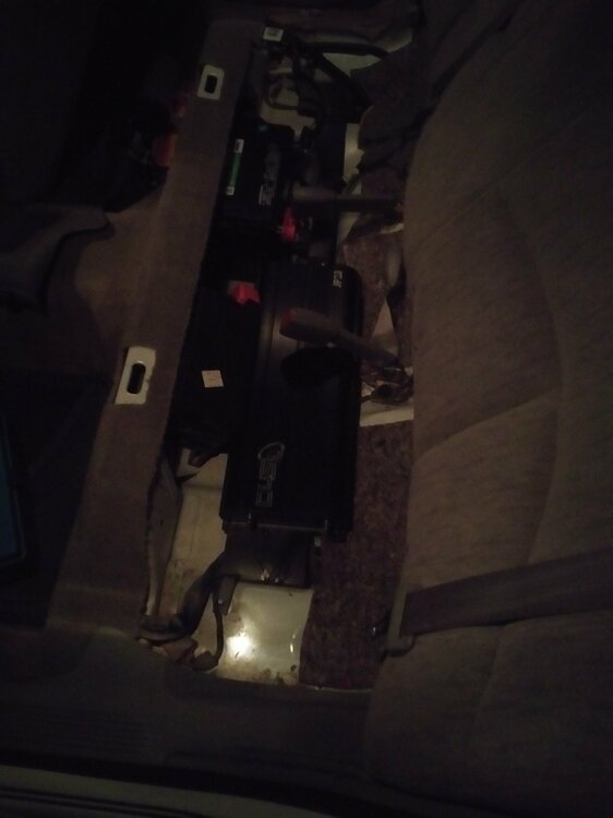

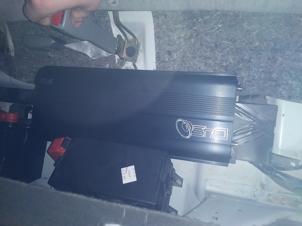

DizzleDizzle Posted January 24, 2021 Report Posted January 24, 2021 Will I have overheating problems if I mount my amp under the rear seat by where the battery goes? Like shown in the pictures? It will most likely be a temporary situation because I cant fit more than one amp under there but I'm trying to avoid having to crawl into to trunk to tune the amp for now its easier to pop seat out and tune away.
Just a guy Posted January 24, 2021 Report Posted January 24, 2021 Hard to say for sure, really will only be able to know by trying. I've always mounted my amp's underneath the driver/pass seats. Not much air flow, and have had minimal issues. In my Toyota pickup, my infinity reference would get very hot, and went into protect. I made some spacers to allow a little airspace between the amp and the floor and had no more issues after that. Worst case, you could install a fan in the footwell.
DizzleDizzle Posted January 28, 2021 Author Report Posted January 28, 2021 Thanks for the help. I decided to trash that ideal and just build a panel to mount the amp in the trunk.
