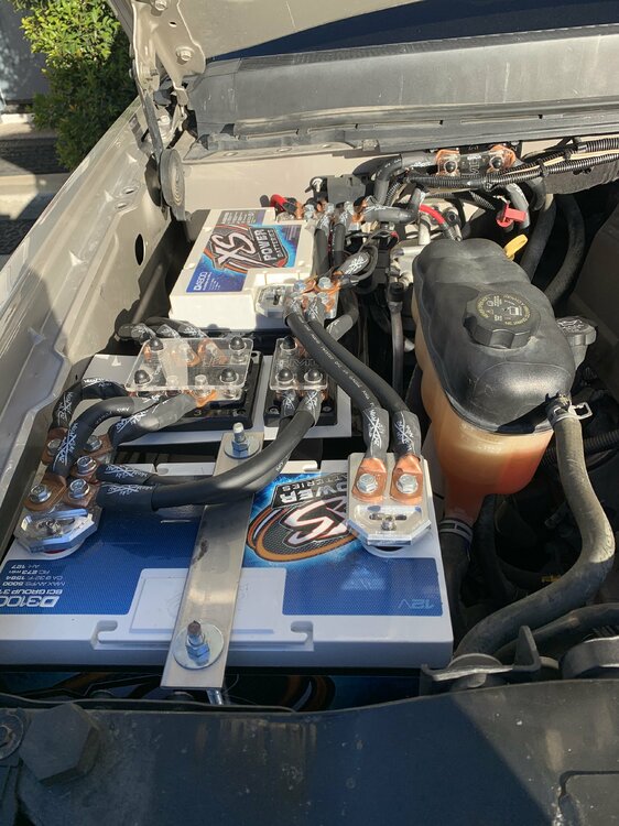

Manny_7579 Posted January 27, 2021 Report Posted January 27, 2021 So this is my current set up right now I’m just wondering if it matters where I’m pulling the power from for my amps I want to add a 3rd one and I was thinking about just tapping into the 2nd one I have and call it good Or do my amps have to be pulling power from the last battery in the set up? also would my mechman 320 be enough for charging the 3 batteries xs power D4800 and 2 D3100 thanks in advance
Dafaseles Posted January 27, 2021 Report Posted January 27, 2021 It doesn't matter. If you hook all the batteries up together, it essentially makes one battery. Just make sure you're grounded really well. 2011 Chevy Silverado under construction My build log here. Check it out!
Manny_7579 Posted January 27, 2021 Author Report Posted January 27, 2021 @Dafaseles hell yeah right on bro thank you and the mechman should be fine with the 3 batteries right
Dafaseles Posted January 27, 2021 Report Posted January 27, 2021 1 hour ago, Manny_7579 said: @Dafaseles hell yeah right on bro thank you and the mechman should be fine with the 3 batteries right That depends on your draw. If you're pulling 25,000 watts, it's not enough. If you're pulling 1000 watts, waaaaaaaaay more than enough 2011 Chevy Silverado under construction My build log here. Check it out!
Manny_7579 Posted January 27, 2021 Author Report Posted January 27, 2021 @Dafaseles alright yeah all I have is a T2500 bdcp paired up with 2 jl W7 13.5 and 2 600-4
Dafaseles Posted January 27, 2021 Report Posted January 27, 2021 40 minutes ago, Manny_7579 said: @Dafaseles alright yeah all I have is a T2500 bdcp paired up with 2 jl W7 13.5 and 2 600-4 You've got tons of reserve. You're way good man! If you have any voltage issues, something else is the matter 2011 Chevy Silverado under construction My build log here. Check it out!
Manny_7579 Posted January 27, 2021 Author Report Posted January 27, 2021 @Dafaseles Fuck yeah....I don’t really have voltage issues I just have an extra one laying around figured I just add it thanks for the help bro!
