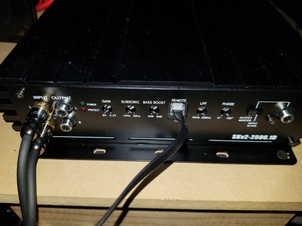

Dafaseles Posted February 18, 2021 Report Posted February 18, 2021 What are your settings on the amp and did you use the same LOC on your last setup? Also you could test with a digital multimeter and make sure you're getting plenty of power to the amp, and make sure enough power is going through the RCA's to the amp 2011 Chevy Silverado under construction My build log here. Check it out!
ItalianStallion13 Posted February 18, 2021 Author Report Posted February 18, 2021 23 minutes ago, Dafaseles said: What are your settings on the amp and did you use the same LOC on your last setup? Also you could test with a digital multimeter and make sure you're getting plenty of power to the amp, and make sure enough power is going through the RCA's to the amp Setting on the amp are bottomed out. Same LOC as last sub. I have a cheap MM is there a way to test without having to run all the way to the battery? My MM has the cables perm connected to it. Also RCAs... do I put a lead to the jacket and one to the post??
Dafaseles Posted February 18, 2021 Report Posted February 18, 2021 To test the RCA's, put a node on the center post and one on that outer ring around the post. It won't be a huge amount of voltage, but just to verify it's getting to the amp. Then just test the power cable by just the positive node on the copper, and the other on wherever your amp is grounded, or just a good ground. If your voltage is dropping quickly, the amplifier could be going into protect. By all settings are bottomed out, does that mean you have your low pass filter set to 35 hz? 2011 Chevy Silverado under construction My build log here. Check it out!
ItalianStallion13 Posted February 18, 2021 Author Report Posted February 18, 2021 8 minutes ago, Dafaseles said: To test the RCA's, put a node on the center post and one on that outer ring around the post. It won't be a huge amount of voltage, but just to verify it's getting to the amp. Then just test the power cable by just the positive node on the copper, and the other on wherever your amp is grounded, or just a good ground. If your voltage is dropping quickly, the amplifier could be going into protect. By all settings are bottomed out, does that mean you have your low pass filter set to 35 hz? Ok I will check the voltage. What should it be at to be good? The batt cap is showing 12 when off and 14.2 when on if I remember right. Yes Gain 6, Sub 10, Bass 0, LPF 35, Phase 0. And Output Master.
Dafaseles Posted February 18, 2021 Report Posted February 18, 2021 14 is where it's supposed to be. It's your low pass filter. What that does is not let notes above the setting pass through. Set it to about 80 hz. And your subsonic filter, set it to half an octave below the tuning of your port. Or if you don't know it, set it to 24 or 25 or something like that. Most music doesn't even play that low in actuality. But that should keep your equipment pretty safe. 2011 Chevy Silverado under construction My build log here. Check it out!
ItalianStallion13 Posted February 18, 2021 Author Report Posted February 18, 2021 6 minutes ago, Dafaseles said: 14 is where it's supposed to be. It's your low pass filter. What that does is not let notes above the setting pass through. Set it to about 80 hz. And your subsonic filter, set it to half an octave below the tuning of your port. Or if you don't know it, set it to 24 or 25 or something like that. Most music doesn't even play that low in actuality. But that should keep your equipment pretty safe. Awesome thanks I will try! Box is set to 34hz I believe. Should I also try to adjust the LOC?? I noticed it has tuning holes but havent found any info on how to tune.
Dafaseles Posted February 18, 2021 Report Posted February 18, 2021 I would try and download the user manual for that specific line out converter. That should point you in the right direction for those settings. 34÷2=17 (one whole octave) 17÷2=8.5 (let's just call it 8 ) 17+8=25 hz (half an octave below port tuning) Let me know if that helps you out 2011 Chevy Silverado under construction My build log here. Check it out!

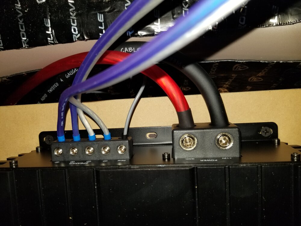

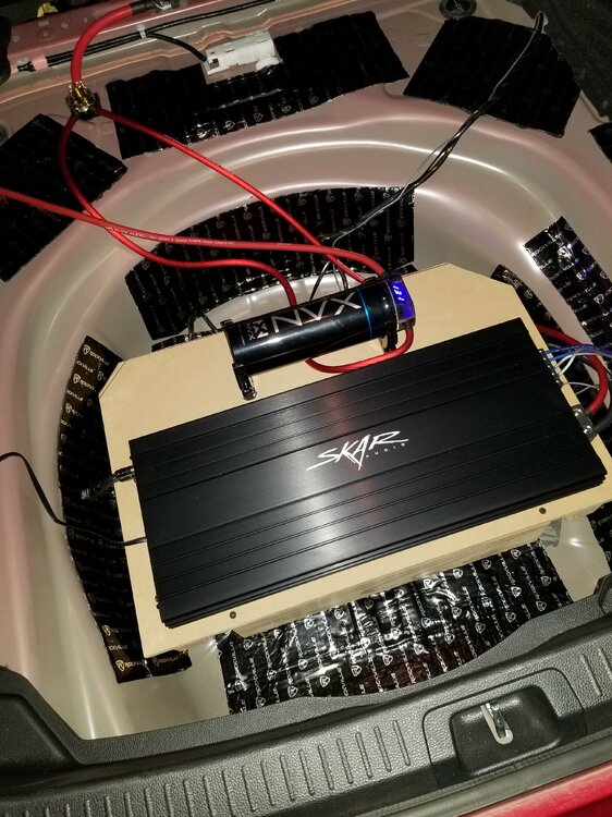

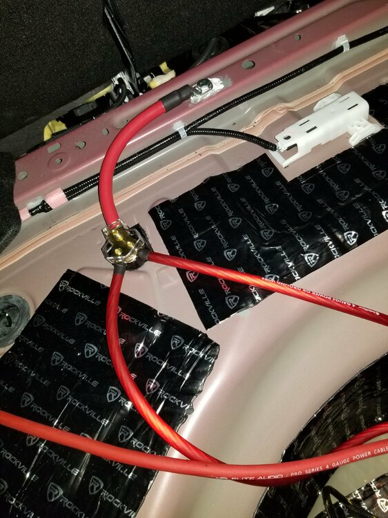

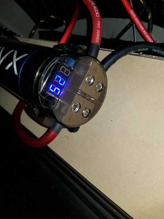

ItalianStallion13 Posted February 19, 2021 Author Report Posted February 19, 2021 Ok sooooo same result lol. Not moving subs at all so I decided to take pics. Yes almost all my wire is red lol you work with what ya got. Red wire from top left is Battery to bat cap, Red wire to split is Ground. 0ga down to 2 4ga, 1 to amp ground and 1 to cap ground. Black wire from pos cap term is power to amp. I did notice that while the stereo is running the batt cap display turns off... So maybe its not sending enough power to the amp... OR the amp isnt pushing enough to use the cap. IDK. lol Display was at 12.5 with car off idk why the 1 didn't show up in the pic.
Dafaseles Posted February 19, 2021 Report Posted February 19, 2021 So, when the bass hits, the cap turns off? 2011 Chevy Silverado under construction My build log here. Check it out!
