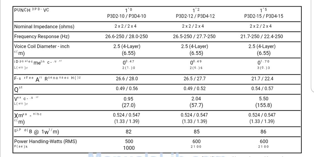

So,  I'm looking to put 2 fosgate p3d4-15 subs in the space that my rear seats used to occupy.
I am not proficient in win isd, have tried using it to no avail.
From what I have found around the net is that these subs do very well in around a 3ft^ sealed enclosure.
My question is, if I put the two subs in the same chamber, would I just double the box size to 6ft^?
I plan on running these off a single amp at 1000-1200 watts at 1ohm.
Any input would be greatly appreciated.
T/S parameters are attached (far right)Screenshot_20210219-205517_Chrome.thumb.jpg.ef0119178233e45e31176bd1a5420017.jpg
Yeah, you would just double the size for double the subs. You have to account for the subwoofer displacement as well...
3 cubic ft sealed per sub sounds like a hell of a lot though..... I'm not a box designer, but I had 4 12's (JL W6's) sealed in about 1 cube gross per sub on 4 1000 watt amps.
I know that doesn't really help you much, just figured I'd chime in
