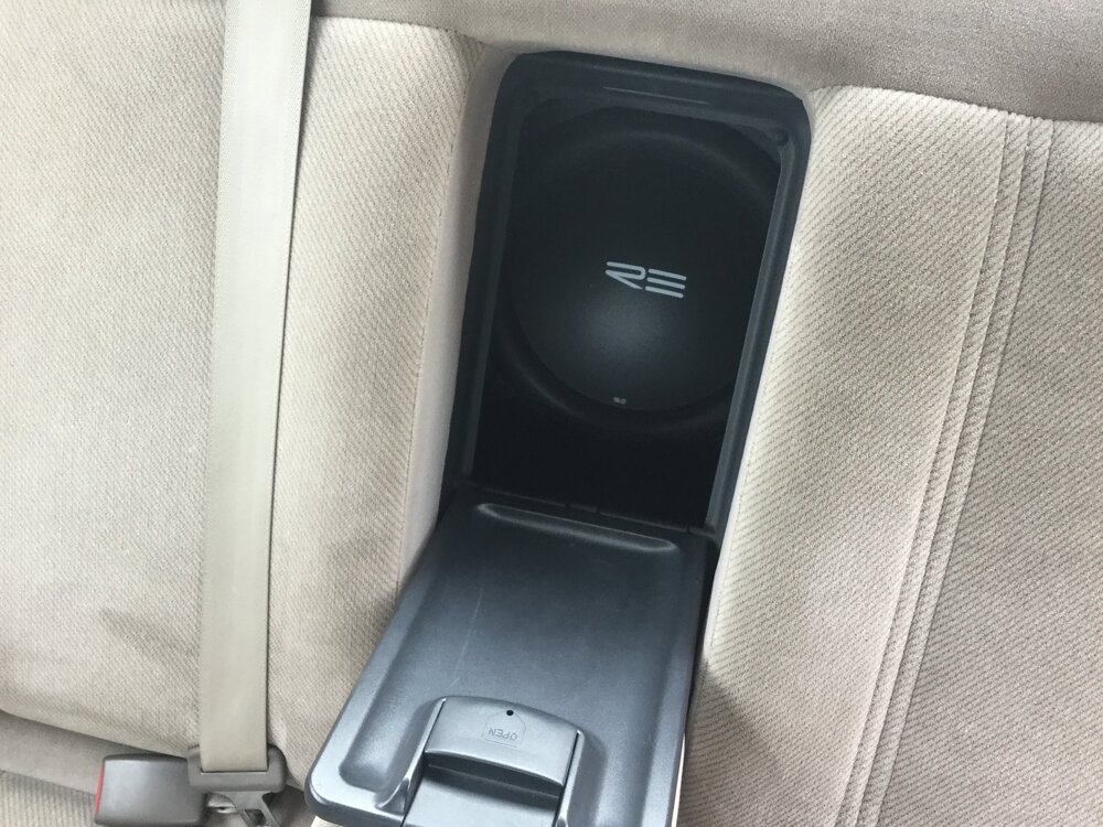

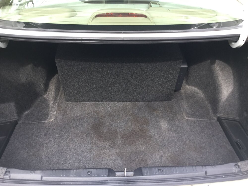

id take the rear deck speakers out first, that will help let the bass vent into the cabin.  heres my 99 Accord.  im running one 12" RE SE sealed
Alpine 9887, Oz 180CS, RF R500X1D, 12" RE SE
