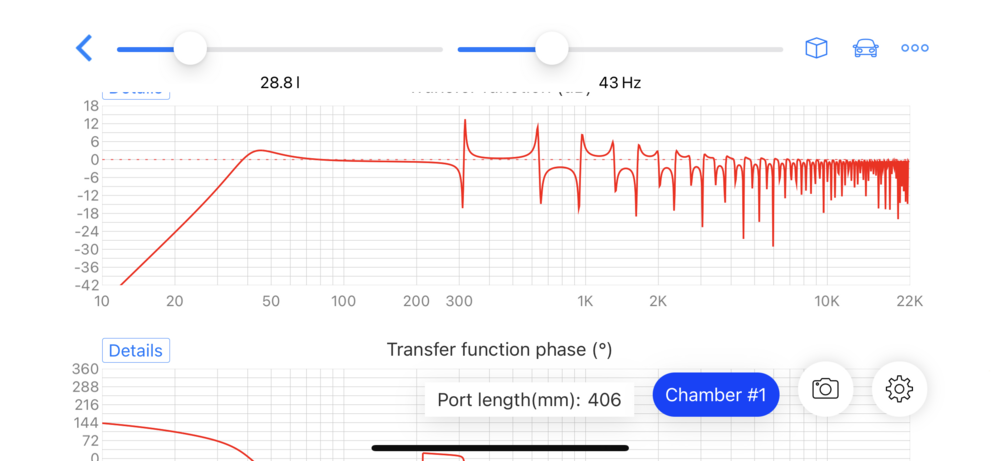

     I know I'm going to catch a lot of flack for choosing a driver from Taramps but if you take a look at their 7 Driver line it's all premium drivers from $100-$400. Anyways, I would like to high pass to mid bass around 60hz. The box specs I was most fond of for this driver is 28 liters, tuned to 43hz with port area 8342mm (4" round, 16" long). I was talking with the manufacturer and he suggested very similar box specs (only tuned 10 hz lower but I'm not trying to go that low) and also suggested low passing over to midrange at 120hz 24db (what do y'all think of that suggested crossover?). These configurations give me flat bandwidth from 70hz-270hz with a small peak around 45hz. Picture of this graph posted below in next post. Would I want to include that small peak in my crossover? Or put it just below that away we are flat the entire response?

8” Taramps 7 Driver Bass1k2
This is what I have I mind for Mid bass. Going in rear, NOT part of doors.
