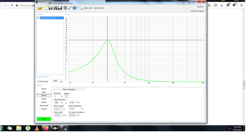

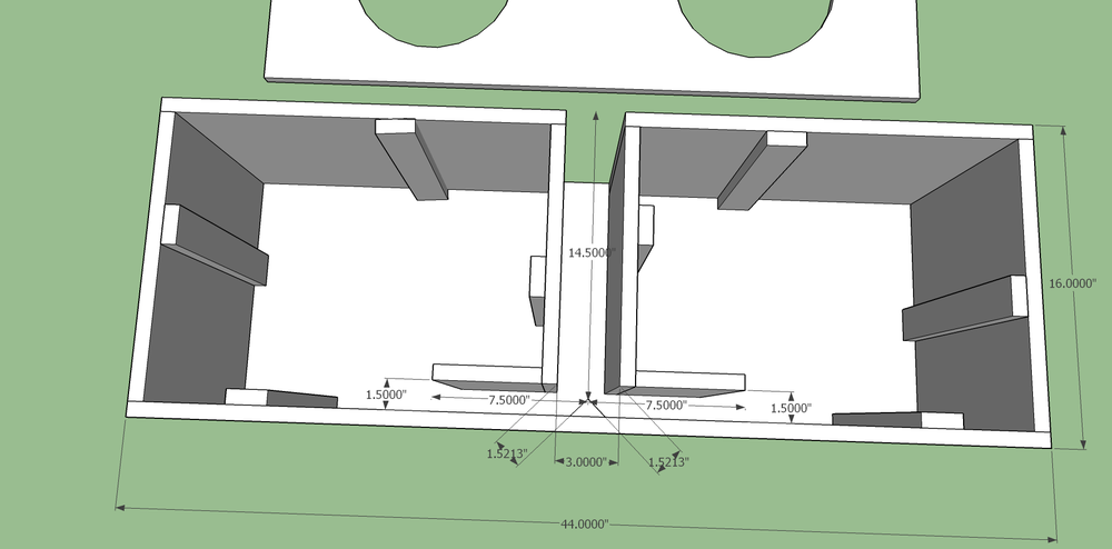

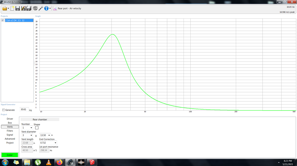

this is my second time building my own box, the first one was super simple i used jbl specs with an areo port and done. this slot port is a little more difficult for me, the box is for 2 sundown SA12 V2s subs up port back thats going in the back of my jeep grand cherokee. the dimensions are height 15" x length 44" x depth 16" .  port is 13.5"x3" - 20" long tuned to ~32hz. im not sure if my port needs to be bigger or not?    thanks for any help

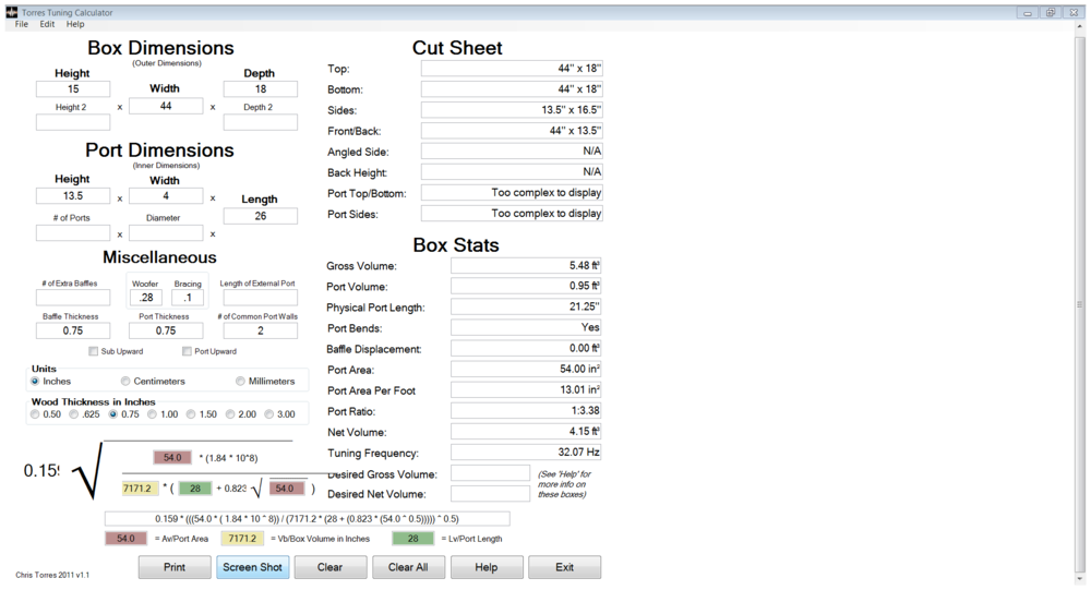

Do you ever plan on upgrading that amp to not be underpowering them subwoofers? If so, then that design is good. But if not, then you need to go bigger, like 4.75 cubic foot net and 4.25” of port width. Jacob (ceo and founder of sundown) says SA subwoofers love around 12sq” of port per cube.
