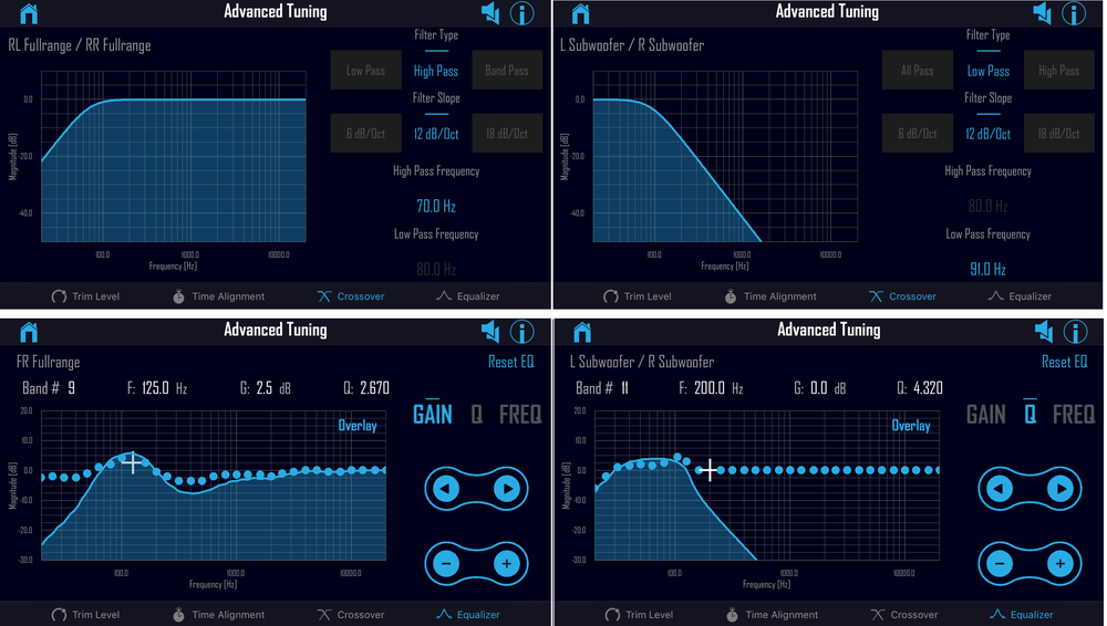

As far as the EQ and other features, it's not going to be as advanced/refined as the Zapco, but it has per-channel gain/x-over/ 31 band EQ and a Q setting.  It has an Apple iOS and Android app, I've found that iOS app on an iPad works the best for me, but the Android app may have gotten better since the last time I set one up.
Here's a picture of several of the settings screens look like:
If there is a T-harness for your truck, it might be the easiest way to go.  It's also small enough that it can easily fit behind the dash or tucked behind a trim panel.
