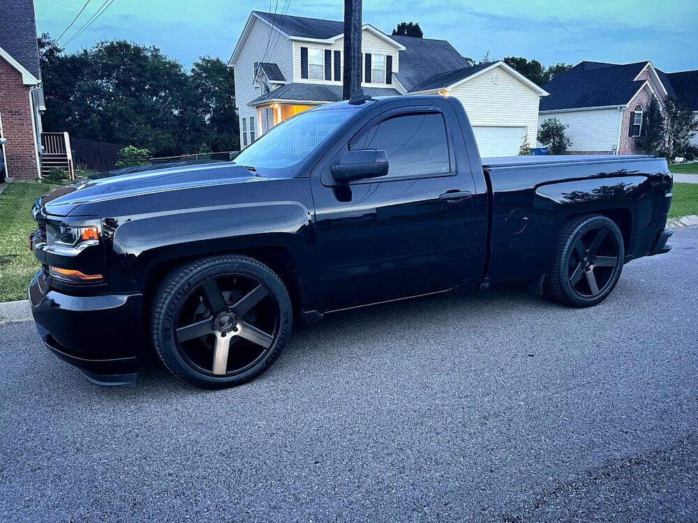

Good evening y’all. I’ve got a 2017 Regular Cab Short Bed Silverado and looking to build my sound system. I am going to have a full custom box built to max size behind my seats then base the subs off what airspace I can get but, I was looking into a set JL 13TW5V2-4 knowing I’ll need shallow mounts and each only needing 0.8sqft of space. Going for more of an SQ build and have heard these are great subs to go with. I was thinking of pairing them up to a Mosconi 1000.1 Amp, Focal KX2 Components with a Mosconi 130.4. All running off the Stinger Heigh10 Head Unit. Maybe some other options on Subs?
Any help would be greatly appreciated. 🤙🏽
