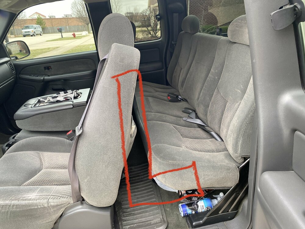

Some weird bends and corners don't effect sound and efficiency as much as others do. Going under your seat, I would say that would effect it. It's a lot harder for the air to get under there, making that part of the box almost useless. (If I'm picturing what your describing correctly)
What I would do is actually place the sub facing up between the bench and the center console, then build the box to extend under the seat. Like a T. Maybe you could port it to one side, or have it sealed. (You also only want your port to have a maximum of 1 bend)
Or, center console build, sub facing the rear would be cool too
Excuse my art skills but im sure u can get the idea. Going to be pressed against the center console and this L shape. Would it be a problem?
Bending it underneath like that isn't exactly ideal.
How many cubes are you looking to get? Will you be able to achieve it with a box like that?

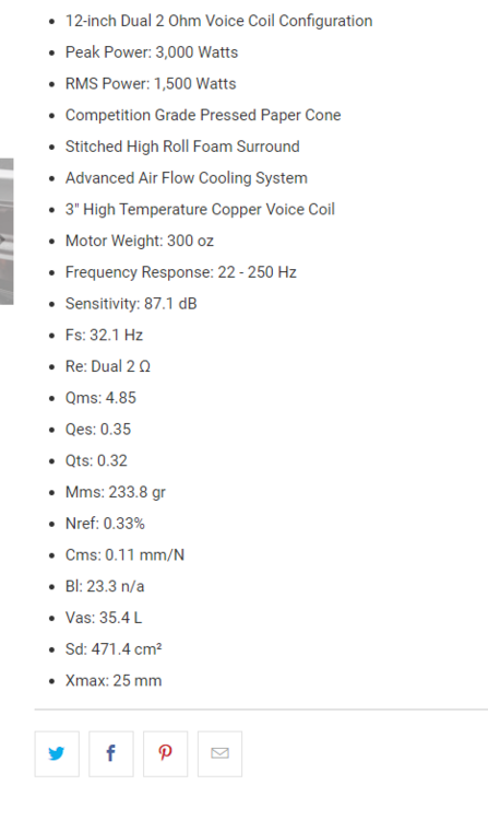

You know, i have no idea. I downloaded winisd to try and figure this out. and watched a few YouTube videos I don't even know where to start. Ill snap a pic of the specs and maybe you can give me some pointers? I would prefer a sealed box. Looking for more punch vs loud distorting sound

Sealed with that sub and that amp, knowing that you'd like a more punchy sound, maybe go with 1.25 cubes. Smaller boxes tend to play more "punchy" while bigger boxes tend to play more smooth and low.
Good to know, thanks for your help. I'm going to try and stay between 1.25 and 1.5. Just going to build the box and then for the center console around it. Ill post in here when i get started. Hopefully soon
