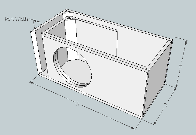

5 hours ago, RachaelM said:
Hey joe. 1 more thing. Both winisd and 12volt giving different port lengths. Can you give me an assist in getting the correct length? The box with be 1.75net, 12.5" x 2". The port will have 2 free ends, no kerf or anything.
28  1/8"  (3 common wall design)
Anyways, even if it is not requested I provide you a possible layout for your reference:
Life saver..thanks alot
