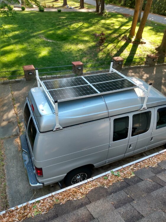

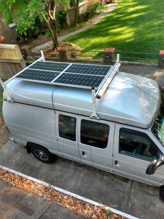

guidecca Posted April 20, 2022 Report Posted April 20, 2022 I'm trying to find out if there is a way to charge my lithium Iron Phosphate (LiFePO4) battery with a second optional 24v alternator. I have a 2008 Ford Econoline E-250 van with four solar panels (400W) on the roof. I want to add a 9000 BTU mini split air conditioner on the rear bumper which will draw roughly 250 to 800 watts. To power the mini split I need more power than the 400W on the roof and someone suggested adding a 24v alternator to charge the batteries while I'm driving. Is there room in the engine compartment for a second alternator? Any help is appreciated.
