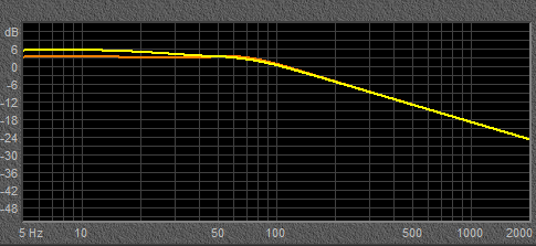

I have 4 18" fi sp4 v1's I plan on doing a build with, it's either going to be a folded flat wall or a 4th, the issue I have with the 4th is according to recommended specs they need 4-6cuft per sub sealed but I can only fit around 3cuft per sub sealed, so wasn't sure if that would be enough to use them properly in a 4th order or not
This is the in car performance of the Fi SP4 18 in a Qtc= 0.707 box (in yellow) vs a 3 cubic feet in red sealed boxes:
So you be the judge, the smaller the rear (sealed) chamber of a 4th bandpass is the less low end you will get.
4 hours ago, CountryBeast199 said:
Hmm ok, I'm now debating even doing a 4th, if i do I can squeeze 3.5 per sealed but I may just do another ported wall or a standard box, idk yet
You’ll be fine with 3 cuft sealed per sub in a 4th order…those box modeling programs need to be taken with a grain of salt since they don’t actually give a accurate cabin gain response graph….I run a 4th order and mine are in around 3cuft sealed per sub and I absolutely murder the lows compared to what my box program suggested it would be…it was about 3 db off of what I got with actual real world cabin gain
