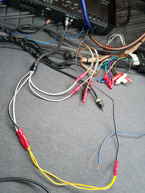

My P1000x1bd not turning when using high level speaker signal with RFI2SW rca adapter.
6v between positive pin and shield on the rca plug.
12v and ground ok on the amp.
Rca plug shield and amp ground has continuity.
Using rear channels from stereo.
RFI2SW connected as instructions.
What else to check or what have I missed or done wrong?

Will it turn on without using the high level to RCA adapter?
