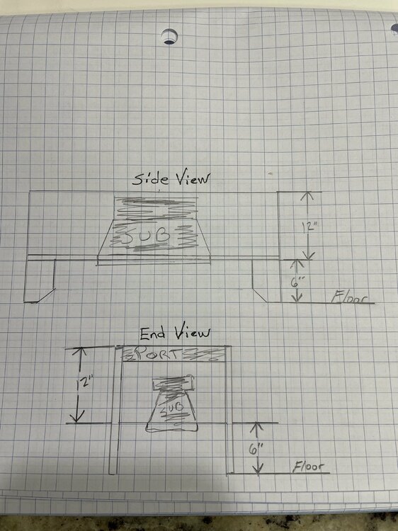

Need some feed back on my boat project. I’m install a removable 15” sub under the seats. I want to be able to drop it in on sand bar days and remove it on fishing days. Right now the boat has 4-8” coaxials and a 10” solobaric laded enclosure in the console. All sounds goods but I want more on sandbar days. I oversized the monoblock that is on the solobaric so interchanging the subs will only require a couple quick connects on the speaker wires and maybe a gain adjustment.
Here’s what I’m thinking.
I don’t have any experience with down firing subs but what I want to do is build a ported enclosure that fires down and the port will breathe forward.
The enclosure will be glassed over and gelcoat to match the boat.
A few questions I have are
1: Is there any problem with using a Skar EVl-15 sub in the down position? I’m not trying to spend a bunch of money on higher end equipment . And I don’t want any free air subs.
2: Is the port ok located on the end or would I get better performance moving it to the bottom also?
3: Will some of you with experience in outdoor applications such as this give me some feedback on this design and if I need to change anything on it?

On 3/31/2022 at 7:50 AM, Joe X said:
The EVL 15 sub will need some 3.5 cubic feet net to work, under those seats all you could fit is a 10" maybe a 12" ported. Also there are marine grade subs for that kind of application.

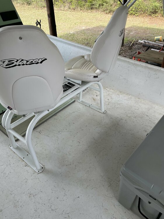

Under that seat is 18” x 26” of clearance and 10’ behind it if Need be. I have plenty of room for a single15 or 3 of them for that matter.
I wasn’t asking about marine grade subs as I am not interested in them at this point. I have used car audio subs in boats for many many years and never had any problems. I was asking about using the standard sub in an inverted position. I was wondering if it would perform the same.
An enclosure 12H x 26W x 28 (18+10) D with a port 10.5H x 4.5W x 30L results in a box 3 cubic feet tuned to 33Hz with barely enough port area,  the box is still undersized for a single EVL 15".  But a single 12" Would do fine.
As far as the sub facing down, there is no problem, many bandpass walls have them all installed that way (facing down) no problem. A stiff suspension would not hurt but you can always call a manufacturer to ask. And glad that you know them those marine grade subs.
Them those WTF ever .
Help me with the length on a box 12” tall, 24” wide, tuned to 38hz please. It will give me something to compare my numbers too. Not being a dick here, but I think your assuming that the finished length will be an issue for my boat.  I have plenty of room. I’ll post another picture below.  Driver displacement is .316ft.
Thanks for any help
Like 32D with the 12Hx24W you give, 3.5 net @38Hz, 47 square inches of port area. Also your driver displacement is off, the 21" Warden is 0.26.
