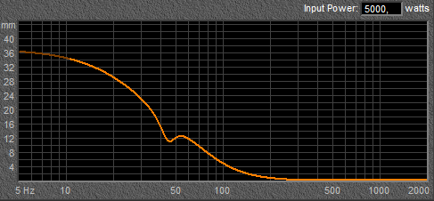

i gotta zv6 18 and the taramps bass 5k im trynna do a 4th order i did my measurements and i got 14.48 cubes before i add the sealed section. so i was thinking 4 cubes on the sealed side and that would leave around 10 on the ported side just need thoughts before the final decision.
Your cone excursion with a 4,10@45Hz  4th bandpass with the Sundown Zv6 18D2 on 5000W is as follows:
As you can see at lower frequencies you hit Xmax =35mm, setting your subsonic filter to 20Hz can avoid that happening or consider less than 4 net.

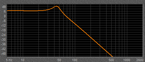

Other than that your projected frequency response using a 2.5:1 chamber size ratio will be very peaky like shown in the figure below.
I’d do 3 cubes sealed side
