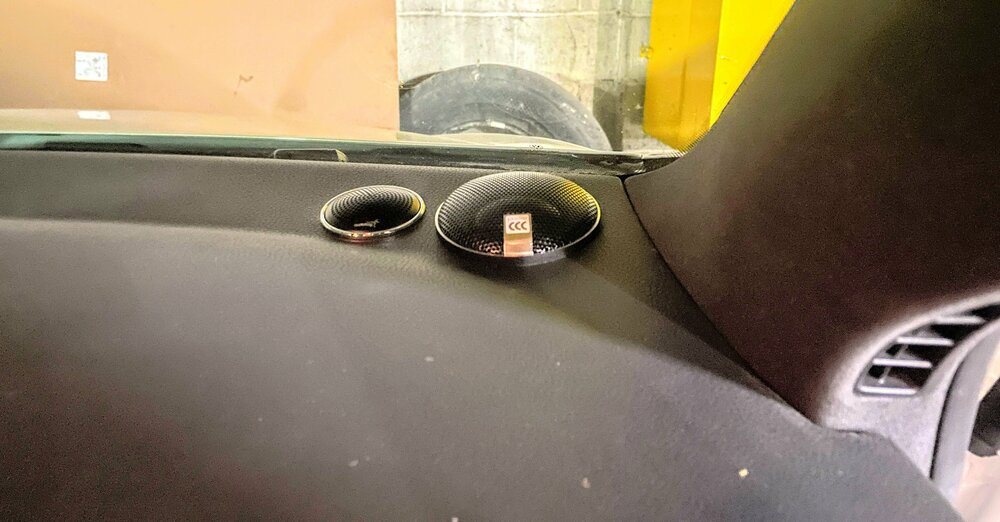

Tweeter (90 watts — flush dash mount)
Audio Frog GS10
Mid (100 watts — flush dash mount)
Morel carbon nano 2.5"

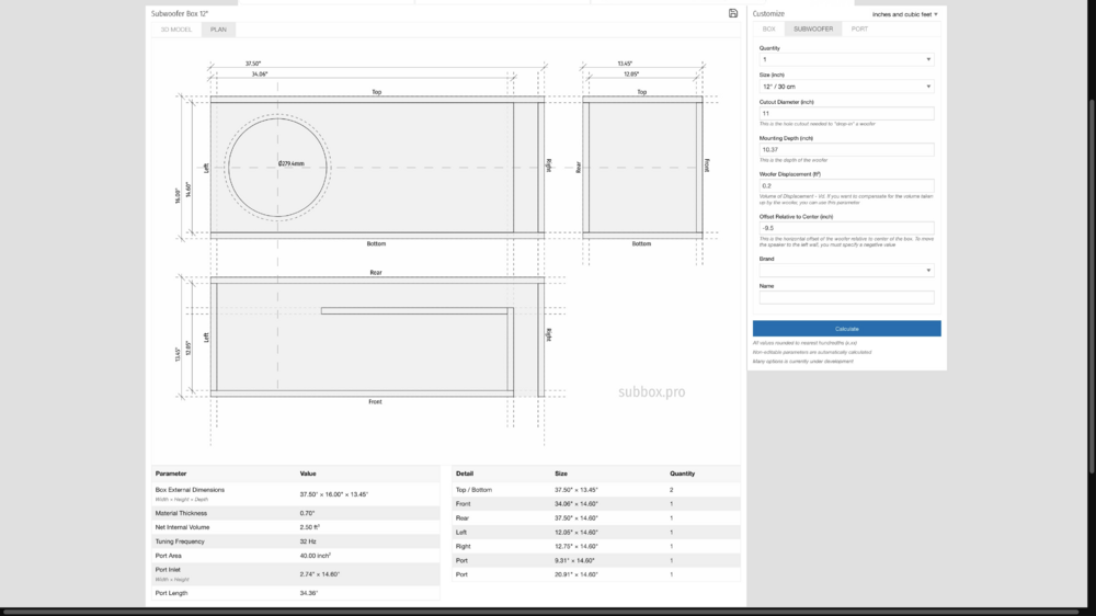

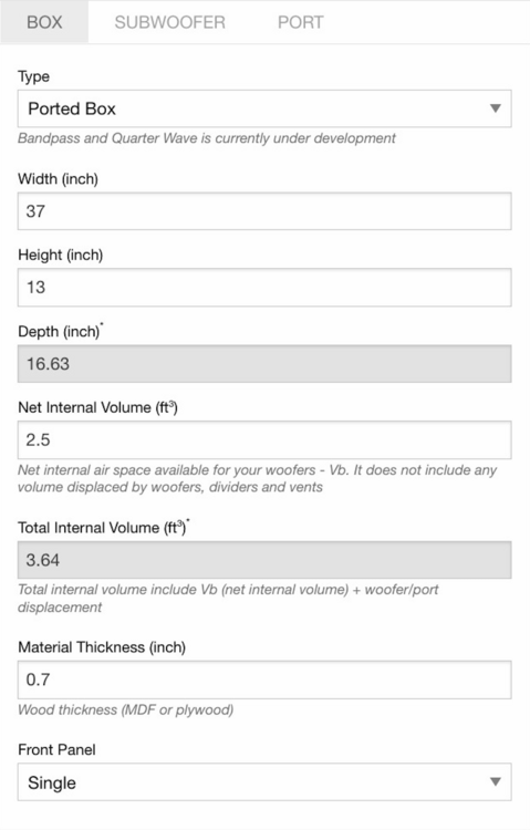

Potential X12 enclosure
2110326469_ScreenShot2022-07-17at6_18_47PM.thumb.png.1234c75be220127aa00ccedd7400f329.png
1529450925_ScreenShot2022-07-17at6_11_05PM.thumb.png.dd72eb913f3becd87ba50e9b42005ab5.png
Build an adapter to install the X12 in your 2 cubic feet net sealed box. Models reasonably flat with very low group delay and strong bottom octave.
