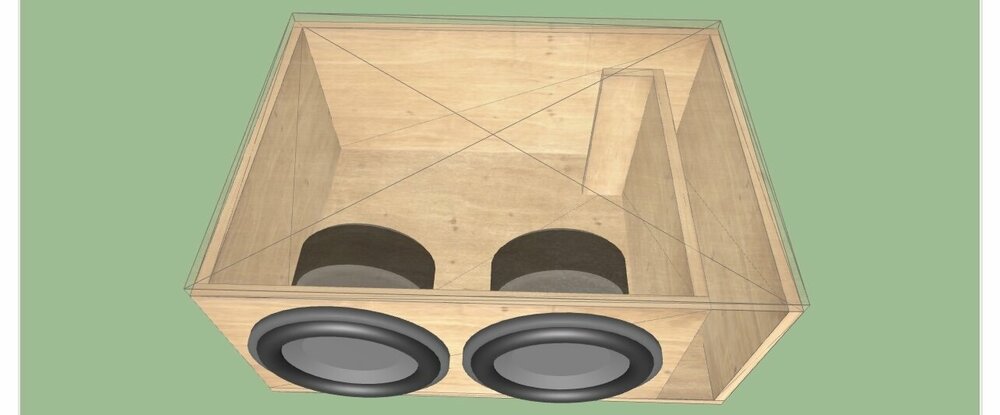

So, I’m helping a buddy build a box for 2 12” wolffram T1 woofers dual 2 ohm, his max box area is 34w, 17H, 40d    He wants a tuning of 34hz is 54 sq of port too less for those?
car 2018 Hyundai Elantra
wattage for each sub is 750 each
so 1500 total

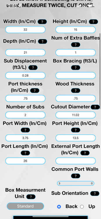

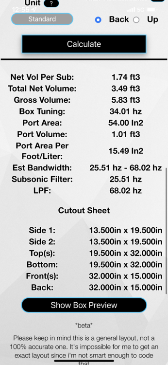

we came up with this box using an app. Can anybody tell me if this looks like it would sound ok? by the looks of the specs?

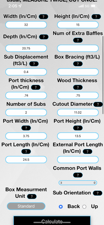

Something looks off with that calculator, or I entered numbers wrong.
I'm coming up different with the port volume being 0.96 cubed, tuned to 35hz and the box being 3.29 cubed after displacements not 3.49 cubed.
If I had to guess I would say that calculator you're using isn't counting that 3 of the 4 port walls are using the exterior panels of the box so its making the numbers different.

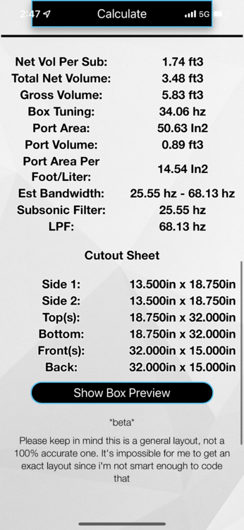

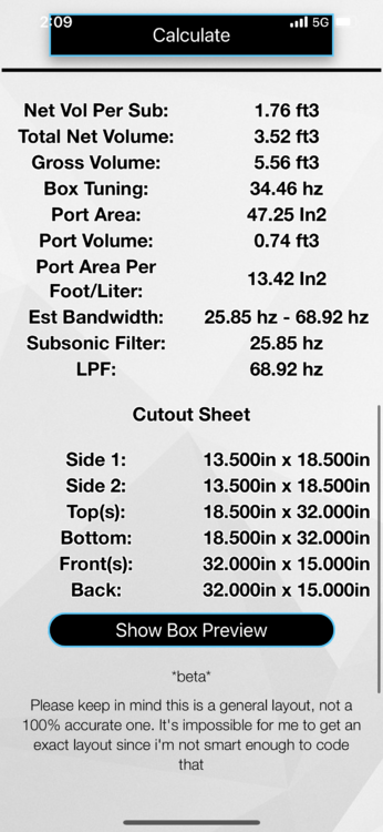

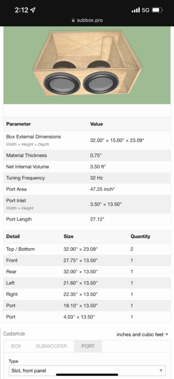

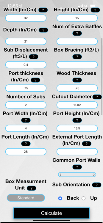

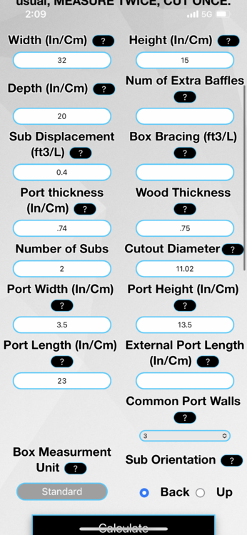

Why do you keep changing the box depth?
You went from 21 to 20.75 to 20 to now 23.09 now....

I'm sure the displacement of those woofers will be about 0.14 cubic feet each which is 0.28 for both, not 0.40 like you're using.

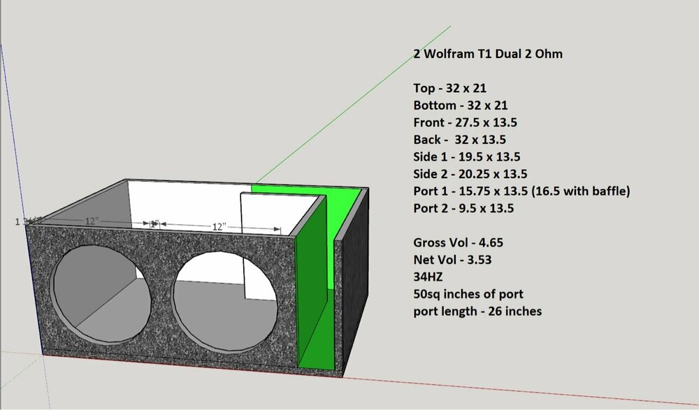

I would go with this:
Height - 15 inches
Width  - 32 inches
Depth - 21 inches
Port height - 13.5 inches
Port Width - 3.75 inches
Port Length - 26 inches
Port tuning - 33.8 Hz
Port area - 50.63 inches / 14.34 square inches of port per cube
Net volume - 3.53 cubic feet after all displacements.
I would probably add a 2nd baffle to the box as well to flush mount the woofers.
Depth changes with sub box pro, when u change port, and sq per inch, thx for the help, those subs have a 3 stack mag which is pretty big I found their older model that says 0.2 on them but they changed the model some,
