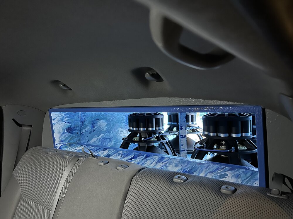

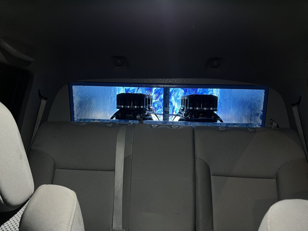

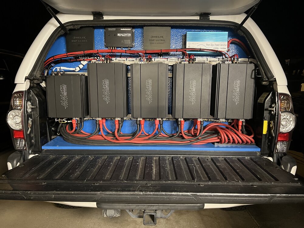

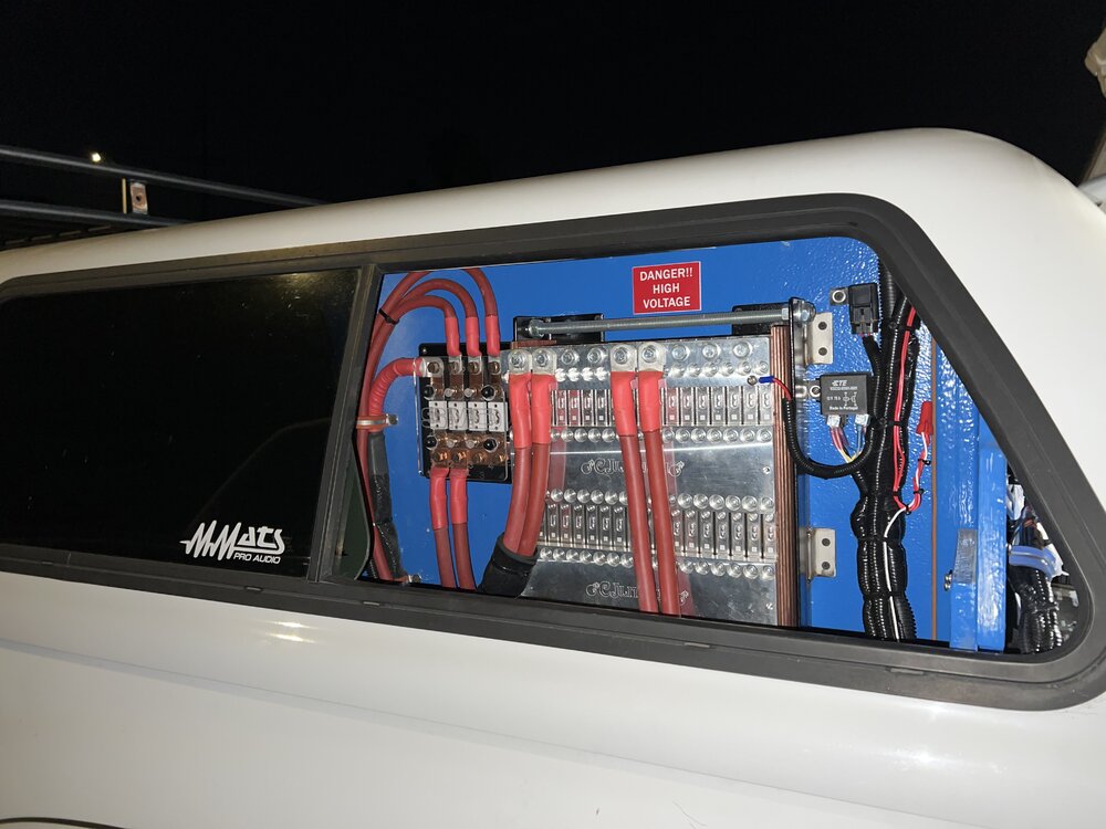

Here are some pictures of my 2012 Toyota Tacoma build. Running 3K per coil, 4 Fi Neo 18"s fully loaded. I have 2 DC power alternators 1 370a for the system and the other 270a for the truck. II posted some info in the electrical section a while ago with details for a second alt on the tacoma/4runner 4.0l engine.
My wife painted the inside of the box using acrylic paint.
Total wattage about 28k.

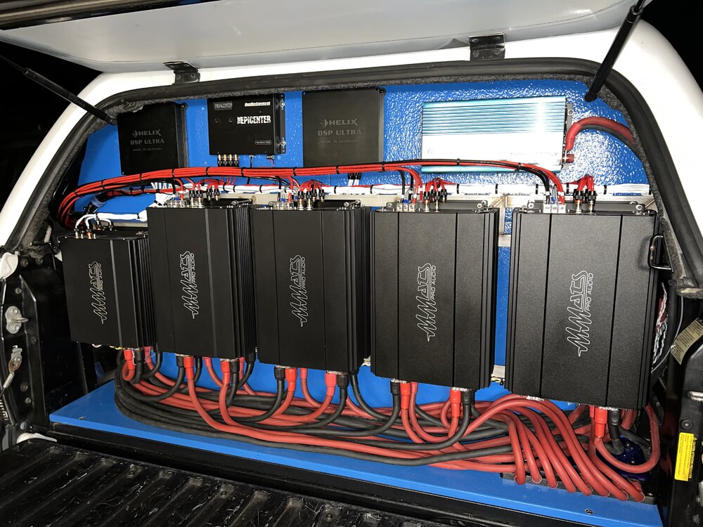

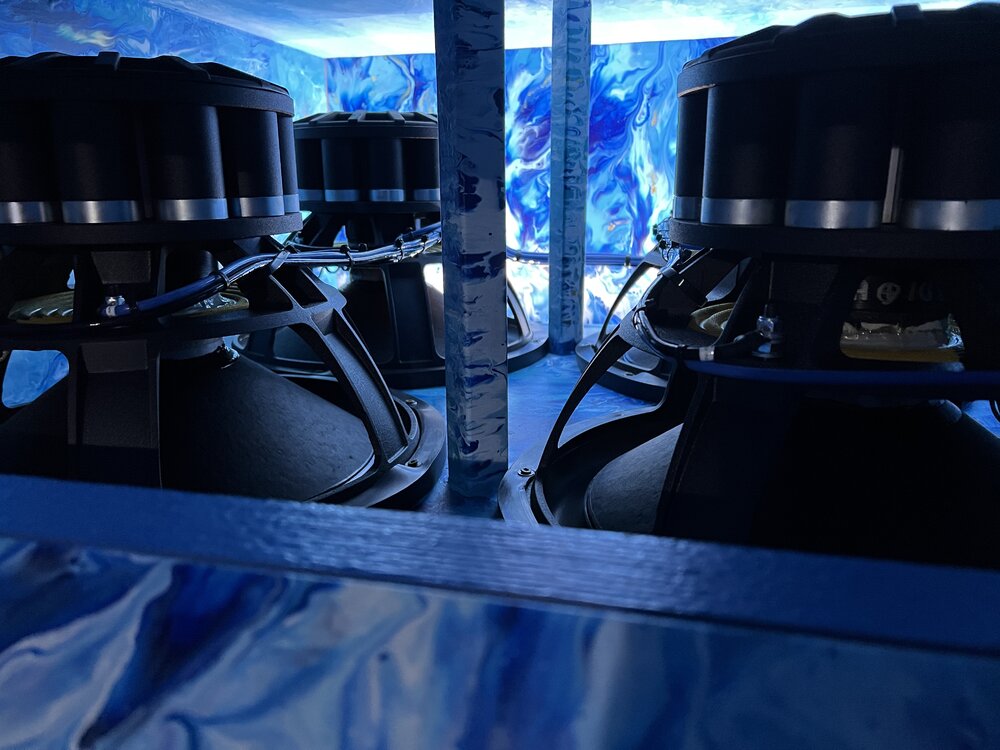

8 mmats 3k for bass
2 mmats Hifi 4250 for Mids
2 mmats Hifi 6150 for Mid bass/tweeters
Plays 15hz on up.

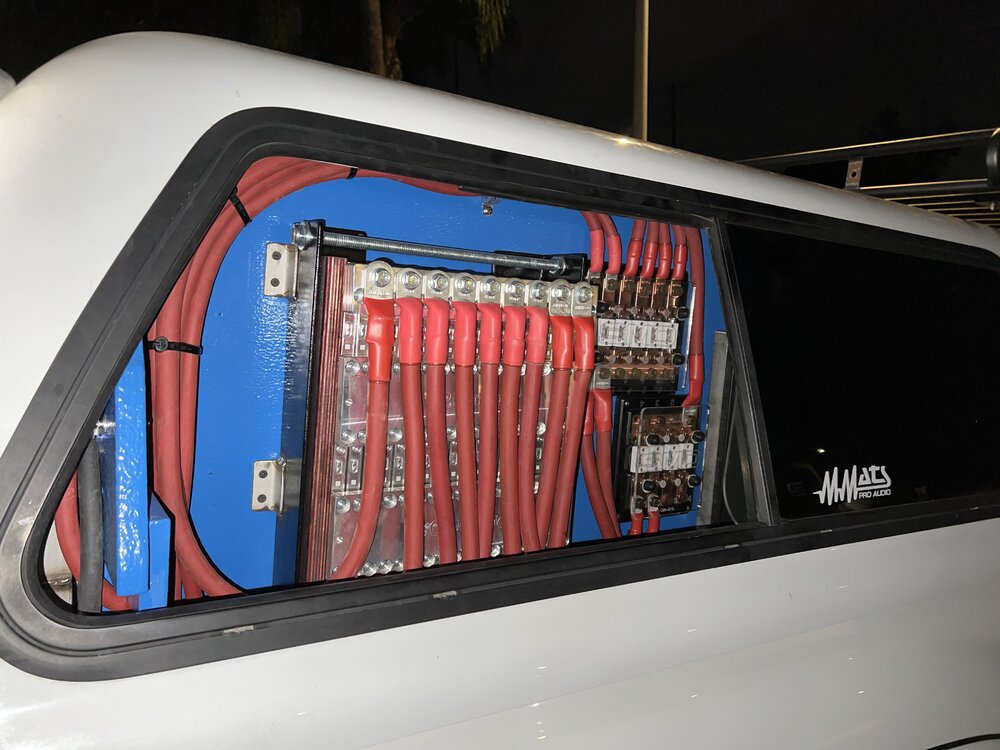

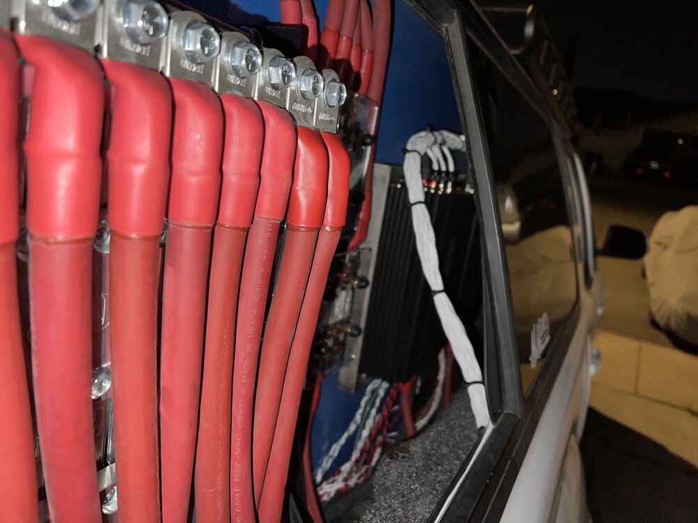

The lithium cells are Panasonic G3, built by CJ lithium. I am adding another 90ah this weekend for a total of 270Ah. wire is 4/0 and 1/0 Flexaprene welding cable. I made custom RCA's for everything.
The blue box on the top right in the amp rack pic is a 1k watt pure sine wave inverter. I have 10amps of 120vac in the back if i want to plug anything in.
I still have a few more things to do to finish the build like make the wiring more presentable.
Feel free to AMA. I designed, built and installed everything.
