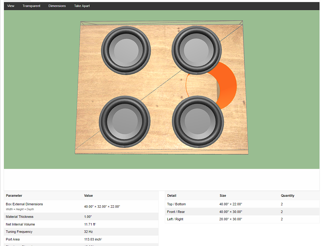

i can go upto about 5.5cft net bigger but i need to decide if i wanna do 4 or 6 even though i have 6 i may just do 4  with a center port and keep 2 for spares
