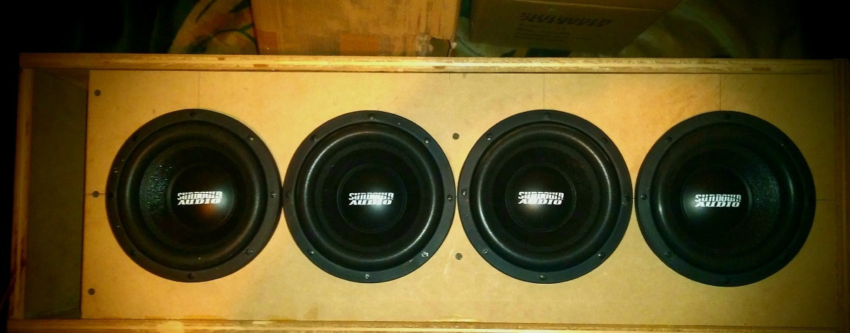

4x sundown audio e8 v6's
built my own 3.6 net cf  slot ported box tuned to 34 hz

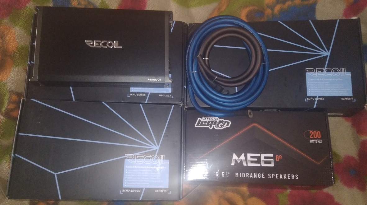

for all the amps im originally wanted to run 2x jp23's and 2x jp34ab's
but i ended up deciding to run 4x recoil audio red 1200.1 for the subs ( 1 amp for each sub at 1 ohm )
and 2x recoil audio rea 600.4 ab amps for the mids and highs

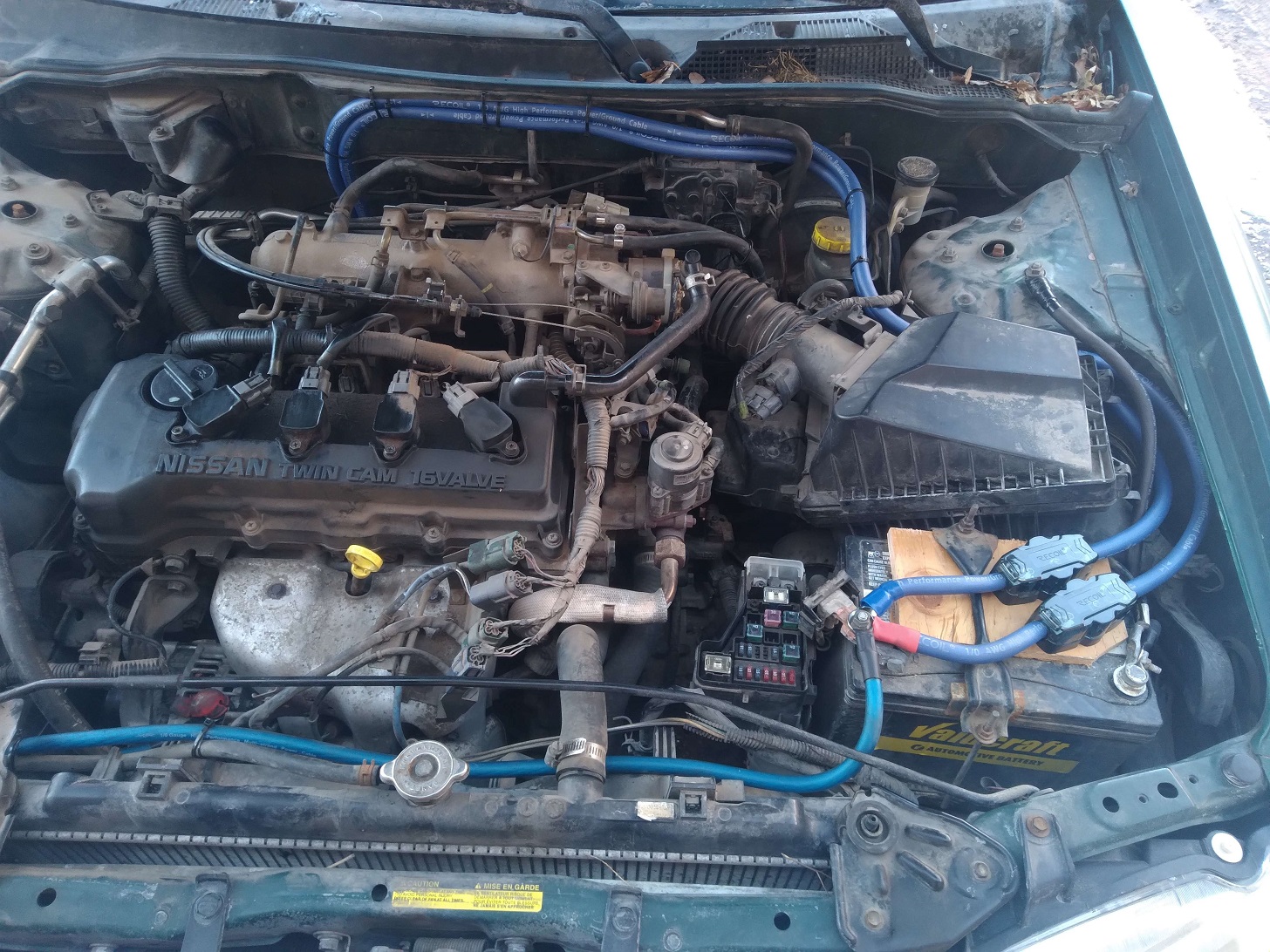

unfortunately for me the biggest alt i can find for this car atm is a 250amp so im going to have to figure something out here more then likley building a bracket to mount a second alt
im also building a 96ah headway bank
4 runs of 1/0 from front to back
due to it being winter progress is slow even though i have most of the pieces needed to get this together
first things to get done will be the alt and running all of the 1/0 runs

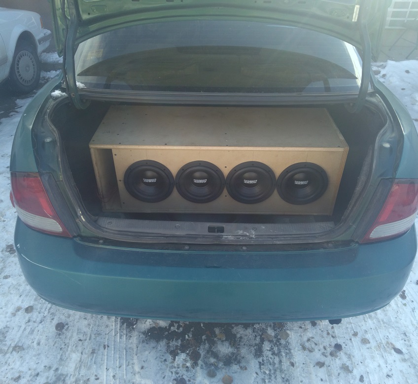

as of right now i put the raw box in the car and im running it on a single red1200.1 and i must say i am very pleased with it on the single amp

that single red1200.1 has my voltage dropping to 11.8 with headlights and blower motor on with the stock alt @ idle, ive found a 300 amp replacement finally that and the 96ah headway bank will solve that
and yes i have the big 3 done already all in 1/0

sorry been super busy with work havent been on at all , im completely removing the rear seats , amp rack is being build into were the seat bottoms would normally be . right now amps are just mounted to a board in the trunk behind the box
i have goten some more stuff done on my last day off mainly just running the new 1/0 cable and installing a second red 1200.1 so now i have them on 2 amps that do 900 rms at 2 ohms each amp is running a pair of the 8's wired at 2 ohms instead of all 4 on a single amp at 1 ohm , @ 1 ohm those amps do 1250 certified and 1500 @ clipping.
i still need to clamp it with the 2 amps and see what im getting for actual power output , maybe tommorow since its my day off
