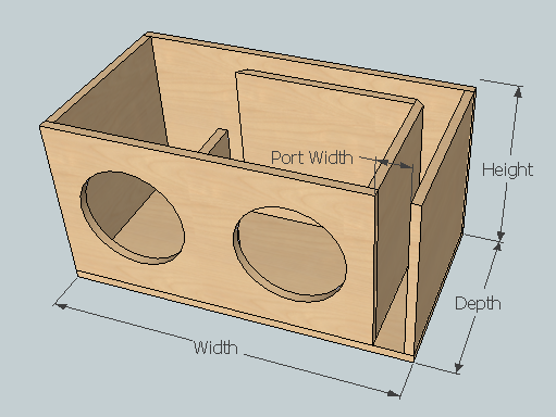

Looking for a ported box idea and tune for 2 SA-10 classic. Ive got some measurements i took from the trunk of my Cadillac Ats-v sedan
H - 16”
W - 29 1/2”
L - 16”
Any help would be great !!

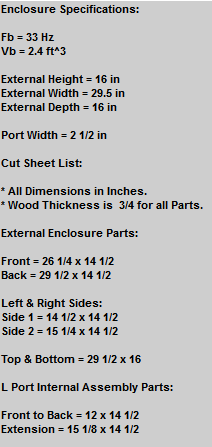

So here is a suggestion, power: to sub(s) rated, amp subsonic filter to 28Hz, minimum port clearance 2 1/2", figure is just an assembly guide:

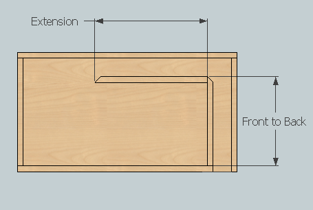

Thanks ! Is 33 Hz the best sound for these sa-10 classics ? And also what is the front to back measurements for the extension in the middle of both sub cutouts?
Around 33Hz will let you play correctly all kinds of music, bear in mind that sound velocity changes with ambient conditions (temperature, pressure, etc) so a given tuning is just nominal.
The following pic shows you what the port parts are, dimensions given are exact for the actual parts to be cut:
