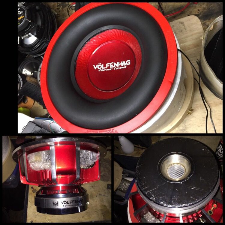

jgi420 Posted March 1, 2023 Author Report Posted March 1, 2023 Old-school comp volfenhag 12s 4812dvx just looking around trying to get the most good sound I can out of them
Joe X Posted March 1, 2023 Report Posted March 1, 2023 You can't really find reliable information on subs that old unless you have the manual. If you do picture it and post. From old forum posts the spec of this sub are 600W rms 1200W peak and the following parameters: Volfenhag ZX-4812DVX fs=26hz QTS=.5016 QES=.5390 QMS=7.2317 VAS=44L SD=.0452 RE=3.2 ohm per coil If this information is correct these are very entry level subs that will work with the ground shaker box you linked and a 1200W RMS amplifier. Hopefully you can post the manual or at least confirm some of the info I am giving you.

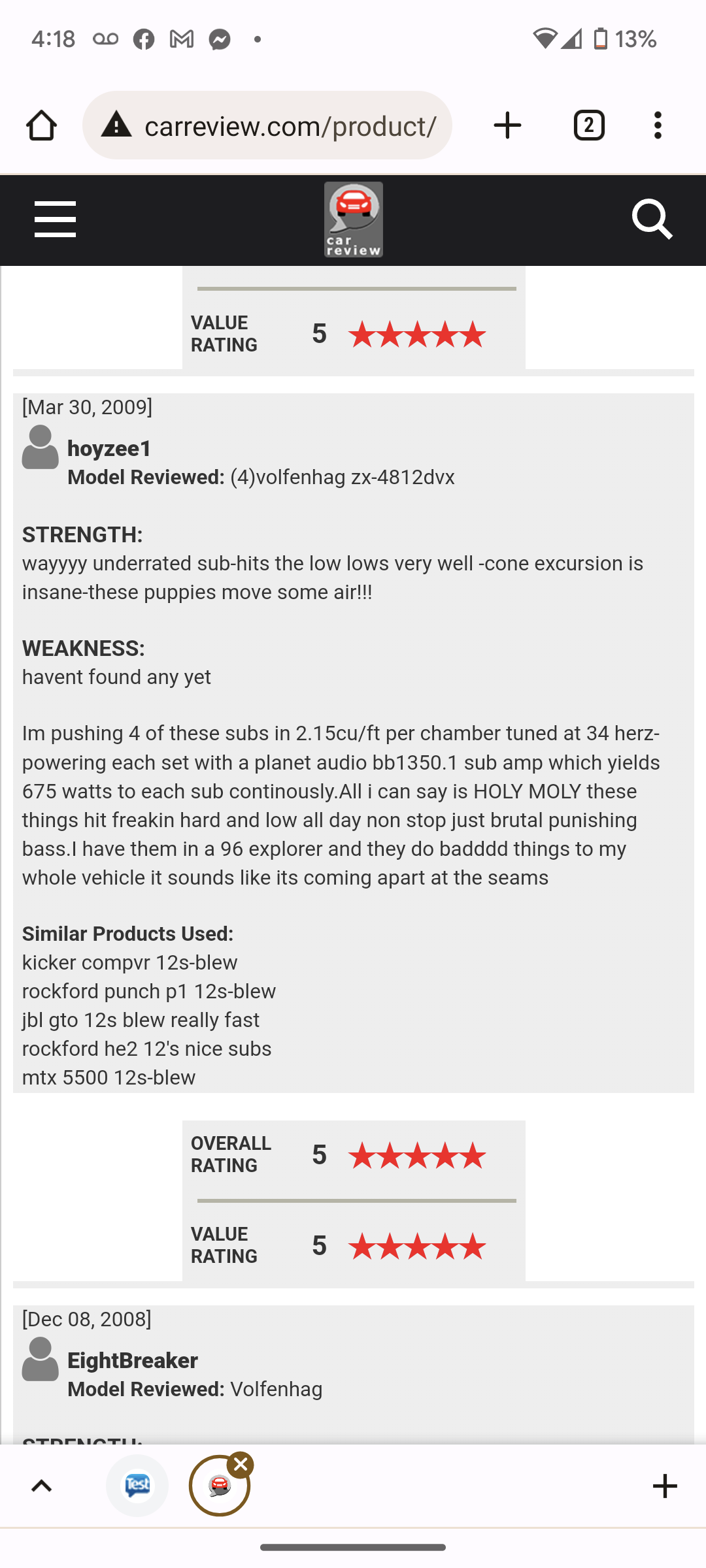

jgi420 Posted March 1, 2023 Author Report Posted March 1, 2023 So far I have found this in a forum. I have a feeling if I do get a new box the subs will still fall out from being 2 heavy. I already have a 1500w mono block hooked up to them seems like they handle it well doesn't seem too loud my rear view mirror is not moving violently or anything
