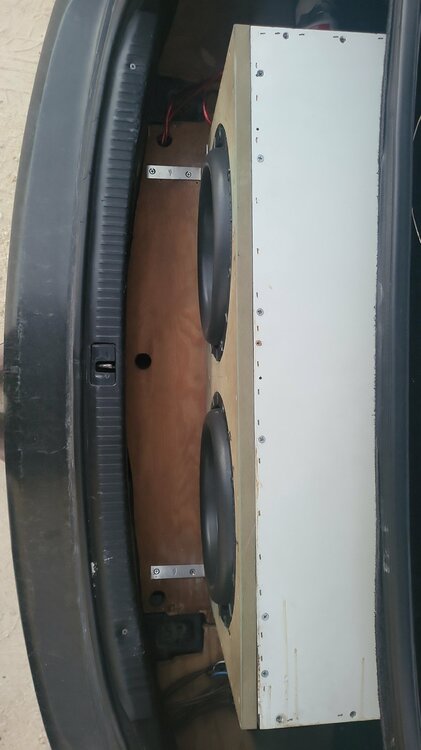

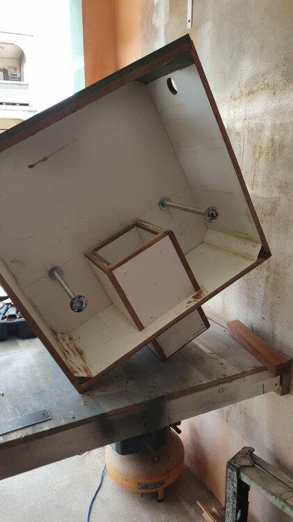

chow8400 Posted April 23, 2023 Report Posted April 23, 2023 Hi All, I would like to identify possible deficiencies or receive some suggestions to change the setup in my car. Its important to note I compete in the stock class, so I am limited to 2500w on the bass amp, a single battery (15v max). I have a Lexus IS250 with Factory Amp Installed and an Android Player. Last SPL Score: 140.7db (2ohm) Equipment 2 DB-SA272 12 (2ohms dvc) 1 Rockford Fosgate T2500-1BDCP 1 JL Audio TwK-88 1 XS Power PWR-S5-3400 1 Mechman 257A Alternator Big 3 upgrade 2/0 AWG Positive (12ft) and Ground (3ft) 8 AWG Speaker Wire (4ft in length) Knukonceptz Twisted RCAs I've wired the subwoofers down to 2 ohms and using speaker A (+/‐) on the Rockford to terminate the connection. I am using second skind damplifier pro mats in a single layer. An image is attached showing the rear for the trunk/sub. The top view of the enclosure is also seen, with the port. Lexus has a ski port, which the extend port of the enclosure goes through. This is due to the fact that my rear seats cannot go down.

Joe X Posted April 26, 2023 Report Posted April 26, 2023 So bear with me as this may get a bit long. The first step is the box, you have a big rectangle port fully internal BUT then looking at the pic you have a fully external port that is clearly smaller that I imagine goes through the ski hole and that has a different (smaller) port area and port length that you don't specify. To match your box specs you should only have a fully internal port 56 square inches in area and 16 in length. That external extension lowers the overall tuning and also reduces the port area significantly.
