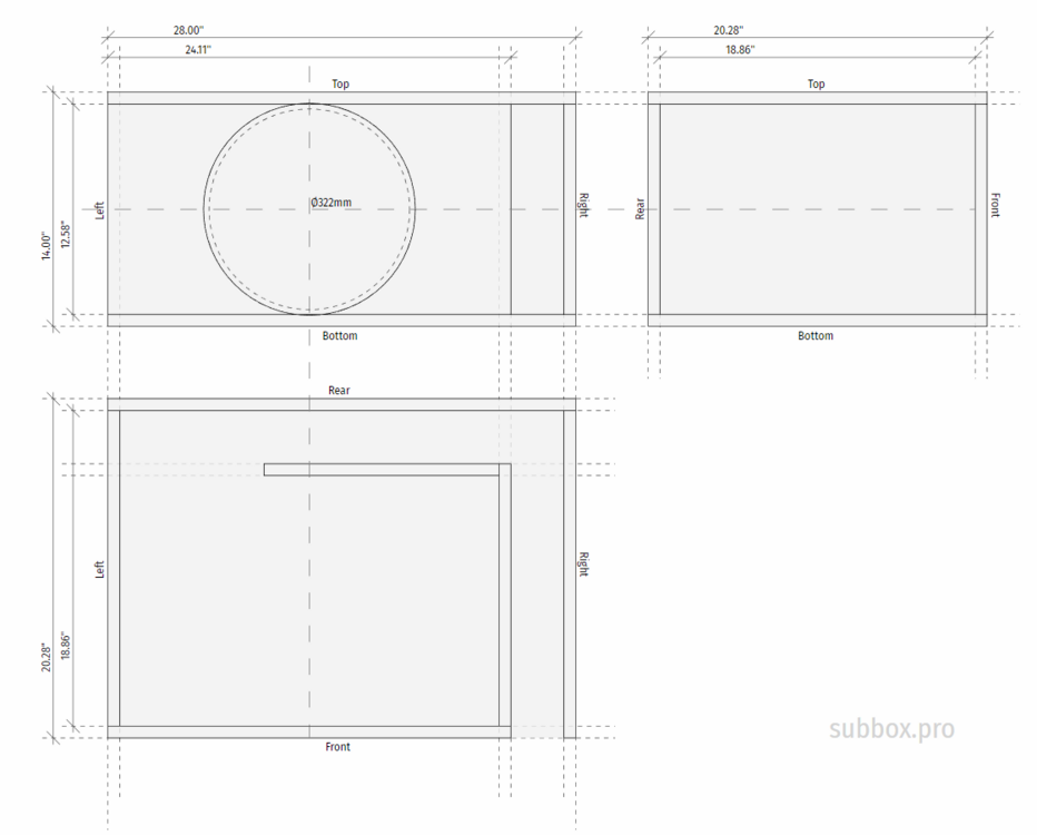

So I recently installed Sundown x12v2d2 with deafbound aab1500 amp wired to 1ohm in my 2020 dodge charger. Stock battery replaced with D4800 and secondary D3400, 0gauge DC/SHCA wiring, 8 gauge speaker wire, RCA's connected to PACamp pro in the back of the H/U. I'm planning to ugrade the mids/hights and sub amp to 2500watt in the future but I have to get this box situatuion figured out.
The sub is playng lows very well, but anything over 40hz sounds like shit. My guess is that box I build is tuned too low. I played a lot with crossovers and moving the box around but it doesnt sound any better..
I used subbox pro website to design the box and I cut it from 3/4" birch on CNC. Dimensions of the current box: 28wx14hx20.5d 2.5CF net and tuned to 32hz as recommended by Sundown. The port area is 40sq inch (3.18wx12.58"hx34.35l).
I was thinking to build a small 4th order. The max dimenions of the box: 30wx14hx20.5d.
Can somebody help me or refer me to the right person that could desing the box for me?
Disregard the hanging speaker wires. I had had audiocontrol hooked up to the rear speakers before I install Pacamp pro..

Just close the port so that the sub runs as sealed and see how it sounds for a test.
