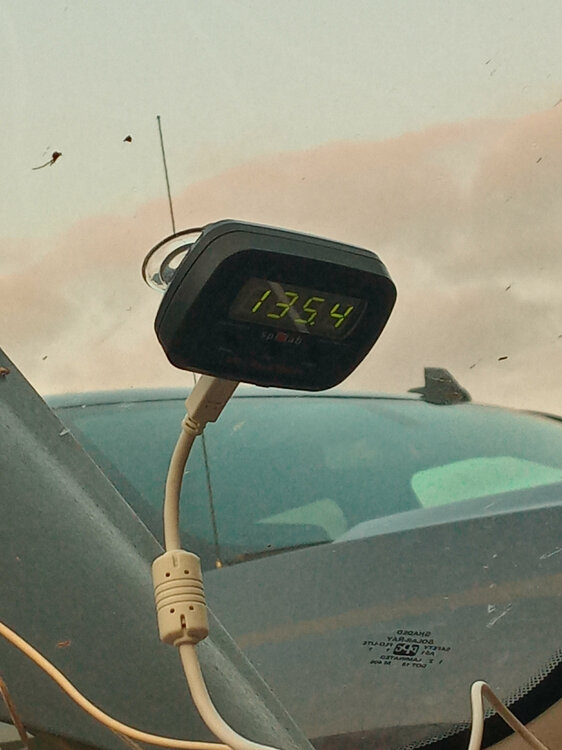

Glass score: 135.4 dB
Kick score: 136.1 dB
@35Hz
These are with windows/doors closed. When I opened them I would lose output.
This is at 800W RMS or Less. I have a 50A fuse in my power wire, so probably less.

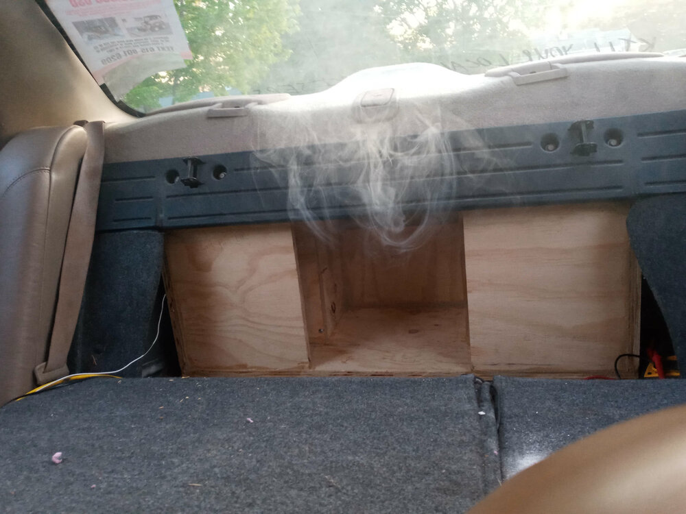

I cut part of the high tuned resonator out and things were looking good! Might cut some more of it out later, because extension in the upper register got better. Then I tried some low notes and noticed I lost SPL, but it seems it was my subwoofer blowing up, actually! Oops and also shoot. I let the smoke out of it.
I’m going to be modifying this box some more and revising it now that I know my tunings are wrong in relation to each other. I may just make the high resonator like the other paraflex designs where the subwoofer mounts with the baffle vertically and the basket facing toward the mouth. I did it this way because I thought my low resonator was tuned much lower around 24Hz, so I made the HTR tuning around 80Hz, now they may be cancelling and reducing output, or loading the cone too much. These designs load the cone a ton as it is.
I need a new subwoofer too. It did not like several minutes on end of test tones.
